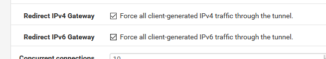

                  @jknott said in see local network ip address on pfsense:
                  I don't seem to have it,
                  Uncheck
                  and you'll see it.
                  @Antonio-Briguglio : check these two, client traffic will get forced through the gateway, and your local LAN's will get included as a route.
                  If unchecked, you have to list your local LAN's that need to be accessible trough VPN.
                  • stephenw10S Online
                    You won't see that if you have redirect gateway set as that routes all traffic over the VPN.
                    The local networks field defines what routes are sent to the client when it connects (if it's not routing everything)
                    So normally you would enter the LAN subnet there. And any other subnets local to the server you want clients to be able to connect to.

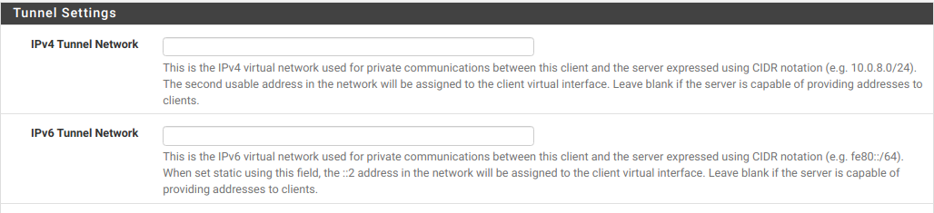

                        Are you referring to this?
                        If so, you don't. I made that mistake when I first set up my VPN and had to change it when I got new hardware, resulting in a different host address. When I started from scratch again, I left it blank, as it says to in the text below those boxes.
                        UniFi AC-Lite access point
                          Indeed. In a TLS/SSL OpenVPN tunnel all the routing and tunnel details are passed to the client by the server.
                          You do not need to set those details on the client.
