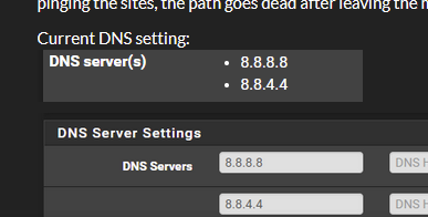

      Hello.
      I am running a 4G modem/router in the UK and am with Vodafone.
      The modem/router is a Zyxel LTE3301-PLUS.
      I am running it in "pass through" mode to the WAN on the pfsense and the external WAN IP is being passed to it.
      The internet is working as it should for the most part, HOWEVER, Vodafone seem to do some funky stuff with the DNS and some sites do not work, when simply pinging the sites, the path goes dead after leaving the modem.
      Current DNS setting:
      Despite the above settings, the DNS settings in pFsense are ignored and it uses the Vodafone ones anyway.
      Can someone please enlighten me as what the ISP are doing and if there is a way around it other than using a VPN.
      Thank you.

          @gertjan said in ISP ignoring my DNS server settings from pfsense?:
          How do you know ? What tests showed this behaviour ?
          I used http://www.whatsmydnsserver.com/
          O 1 Reply Last reply Reply Quote 0

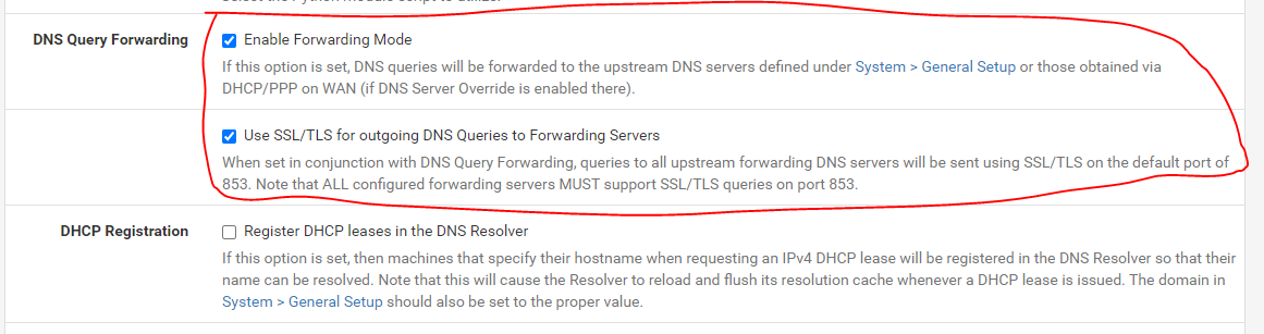

                      @brucexling You can setup a local resolver (bind/unbound) or use the PFSense Resolver and have dns queries forwarded to google (8.8.8.8) or cloudflare (1.1.1.1) using TLS port 853 they wont intercept that. In a nutshell, the local resolver caches and responds to queries from your network and uses google/cloudflare for root
                      Additional config:
                      server:
                      aggressive-nsec: yes
                        forward-zone:
                          forward-tls-upstream: yes
                          forward-addr: 1.1.1.1
                          forward-addr: 8.8.8.8
                          forward-addr: 8.8.4.4
