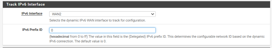

      i'm getting IPv6 via PPPOE and assign it to local LAN via TrackInterface. But the Prefix can be only 0. If i change it to ff there is no route anymore. (Pfsense 2.5.0)

      2021-02-18 14_25_54-Hitzeschild.steingaesser.net - Interfaces_ Freifunk (bge1).png
      traceroute6 -i br0 google.de
      traceroute to google.de (2a00:1450:4013:c02::5e), 30 hops max, 80 byte packets
       1  * * *
       2  * * *
       3  * * *
       4  * * *
       5  * * *
       6  * * *
       7  * * *
       8  * * *
       9  * * *
      10  * * *
      11  * *^C

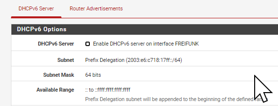

      Information about the Setup
      2021-02-18 14_26_33-Hitzeschild.steingaesser.net - Services_ DHCPv6 Server & RA_ FREIFUNK_ Router Ad.png
      2021-02-18 14_26_15-Hitzeschild.steingaesser.net - Services_ DHCPv6 Server & RA_ FREIFUNK_ DHCPv6 Se.png
      As a side note. Actually there is only one LAN interface which tracks the WAN.

        I just did another test with a second LAN Track Interface on WAN2.
        There i used Prefix 1 and after a reboot (why is this necessary?) the second LAN also get it's IPv6 prefix.
        So it seems you just can use it with increasing values. So why is this the case?
