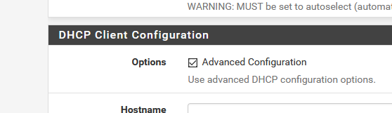

        @itpp21 : just stop to interact with it ?
        Check the advanced DHCP client option :
        where you will find :
