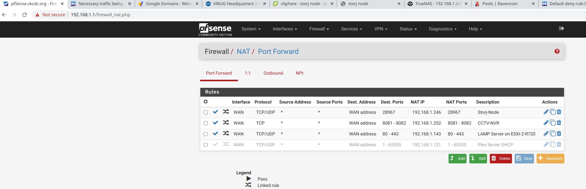

          My storj node is Ubuntu 192.168.1.246 on an ESXi server with mgmt IP 192.168.1.251
          and im not sure that any of these blocks are actually blocks of the storj node. I just have no idea what to do, and im trying to keep my storj node running...

            Post your wan rules, and your port forward you setup.
