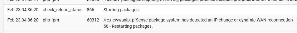

      • in the main system log at the time of the WAN IP address change, it appears it is restarting all packages which includes the DNS resolver.

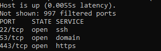

        From the LAN, if I run nmap against the firewall, Ports 443 & 22 are open (https / ssh), however DNS port 53 is closed. Restarting the resolver and a subsequent nmap all is good.
        any thoughts?
