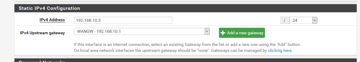

The I had to change the WAN interface to Static, chose 192.168.10.3 and a mask as /24 (not 32).

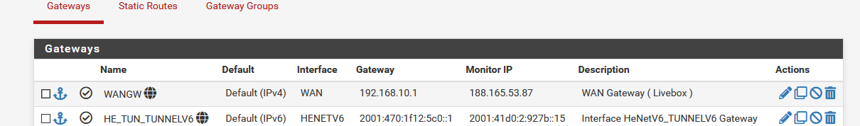

Now I created my new WANGW gateway, where 192.168.10.1 is the IP of my upstream ISP router.
The Monitoring IP is an IP that I own - some server on the net. Not an IP from my ISP.
Now, back to the WAN interface, and I could actually assign the Gateway :

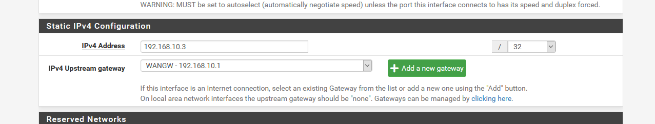

At that moment, I switched back to the /32 network :
but that broke my WAN uplink.
So /24 for the static WAN IP it will be.
edit : my console menu looks like this :
so clearly a /24 on the WAN IPv4 - which is NOT what I stated / showed above, several posts earlier.
