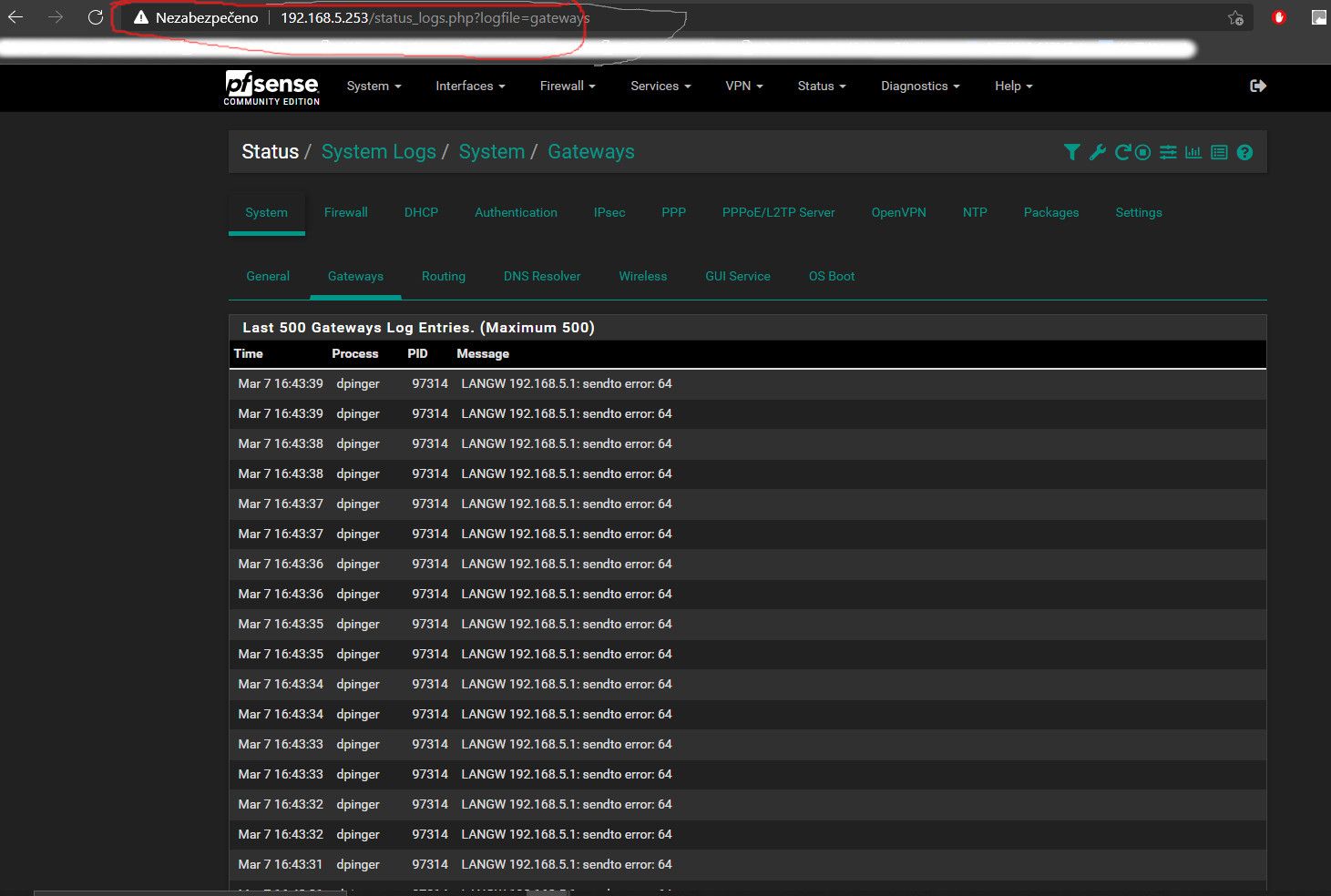

    dpinger 97314 LANGW 192.168.5.1: sendto error: 64

      Good day,
      I want to ask what the error means:

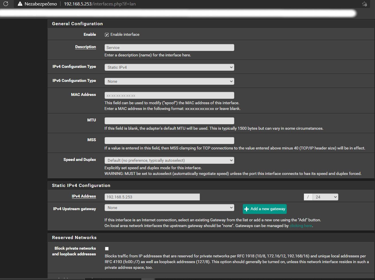

      at 192.168.5.1 I have no device. PfSense is installed at 192.168.5.253.
      I do not observe any anomalies, except for the second listing, the mentioned errors are more mentioned. I have several VLANs, NTP server, DNS server set up in PFSense. OpenVPN is not set correctly yet, so it does not work yet. I have two add-ons installed:

      You can advise where the problem is.
      In the enclosed printscreen, the configuration of the PfSense firewall address settings and the types of images is a list of error messages.
      Thank you in advance for any information that will solve my problem.
      Regards

        Good day,
        so I've figured it out. I had here:
        SystemRoutingGateways
        incorrectly set rule. It's a rule of the OpenVPN tunnel not working yet ...
