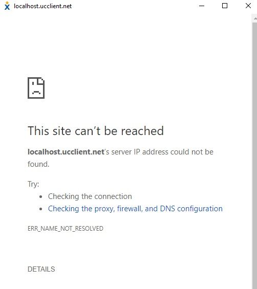

      Hi everybody,
      So we are having a problem at all locations that seem to be DNS related. So we recently moved to a Hosted VOIP solution with Nextiva. All works great, except I their Desktop App says "Site Can't be reached" when using the Pfsense IP as DNS (10.10.10.2).
      If I manually set my NIC's DNS to 8.8.8.8 the app works... no problem.
      Using the Unbound Resolver and performing an nslookup for auth.nextiva.com I get the following results:
      C:\Users\Tech1>nslookup auth.nextiva.com
      Server: pfSense.localdomain
      Address: 10.10.10.2
      Non-authoritative answer:
      Addresses: 54.189.255.225
      54.189.255.224
      Aliases: auth.nextiva.com
      nextiva.customdomains.okta.com
      ok7-custom-crtrs.okta.com
      If I manually set the NIC's DNS to 8.8.8.8 I also get the same results.....I came across a forum where another user had a similar issue and the nslookup also showed Aliases that, at least in that forum they thought could be the issue returning results back to the HOST.
      I have disabled DNSSEC (No luck)....So hoping for some help.... ;o)SiteCantBeReached.jpg

        • N Offline
          nicholsnt
          Clean install pfsense 2.5.0 with no packages installed with the Unbound DNS Resolver enabled. I can disable it and just DHCP the DNS I want to the devices and it works. I can also Use the DNS Forwarder and it works. Just something with the many lookups and Unbound that is causing the issue from what I can tell. This occurs with the prior Pfsense Release version also. Can I create a static entry in the pfsense for each of those aliases to perhaps negate the lookups?
          • N Offline
            nicholsnt
            @gertjan said in Unbound Resolver not working with Nextiva desktop App or Ring Central app:
            Yeah, I get results from an nslookup and DIG and on surface looks like it resolves. But something with using root hints with Unbound breaks the application...
            Would Unbound have any known issues with constant lookups maybe resulting in the application timing out? I can bypass Unbound but I do want to use pfBlockerNG which from what I understand requires the Unbound Resolver...
            Anyway thanks for your help...
