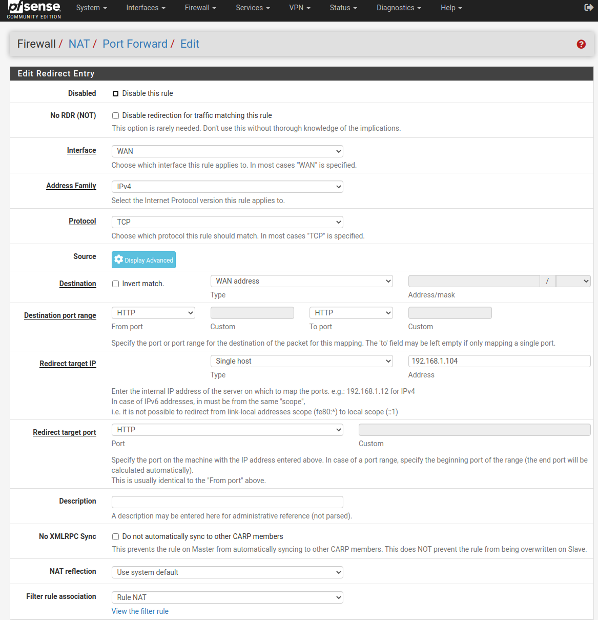

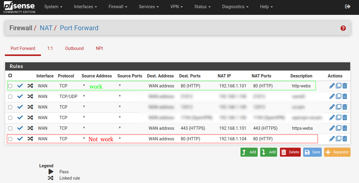

      I have a public IP address on pfsense.
      I have one web server 192.168.1.101, where NAT is on port 80 and 443. This server (NAT) works great.
      Now I have created another web server 192.168.1.104 and I have created another NAT on port 80. It does not work at all and I do not know where the error is.

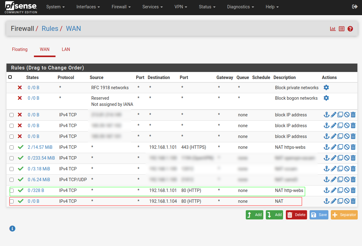

        I have already come to the root of the problem.
        It is not possible to route 2x port 80 to one public IP.
        I tried to block the rule on 192.168.1.101 servers. Then the rule worked on 192.168.1.104 servers.
        But at the same time, I will not work.
        Or would it be possible to work on one public IPv4 address with more than one web server?
