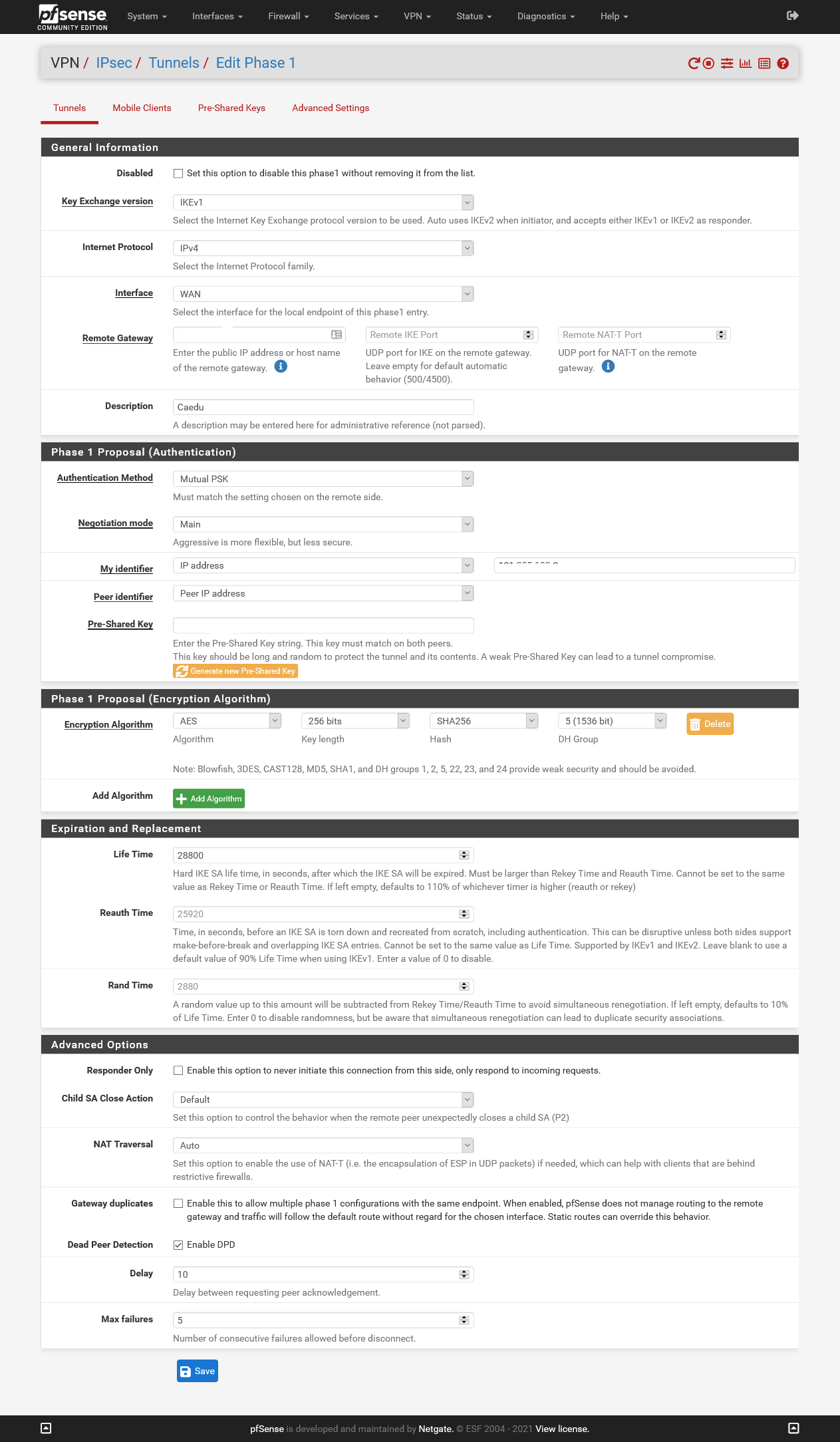

                                      francescouk @jimp
                                      • jimpJ Offline
                                        The problem is likely that all the child SA entries have overlapping names (e.g. a bunch are con0, con1, etc and don't have proper names. I don't see how that can happen on the RC image unless something else altered the code (like maybe you reverted a previously applied patch after upgrading). It was fixed by https://redmine.pfsense.org/issues/11487 at least any case I've been able to replicate is fixed.
                                        I can't replicate what you are seeing here but if there is a lingering issue it could be from something else in your config. If you can attach a copy of the <ipsec> section of your config.xml (with private stuff redacted) that may help.
                                        But first make sure you didn't revert anything in the system patches package.
                                        Do not Chat/PM for help!
                                        F 1 Reply Last reply Reply Quote 1
