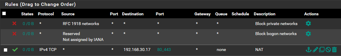

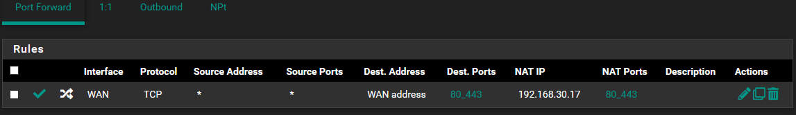

      Port Forward:
      Int WAN | Protocol TCP | Dst WAN | Dst range TCP 80 and 443 | Target IP 192.168.30.17 | Target port TCP 80 and 443 | NAT Reflection: Sys default | Filter rule association: Rule NAT

      Firewall > Rules for Webserver Interface (mvneta0.30) = Bottom rule is allow all through WAN Gateway (disabled rules above it in testing)
