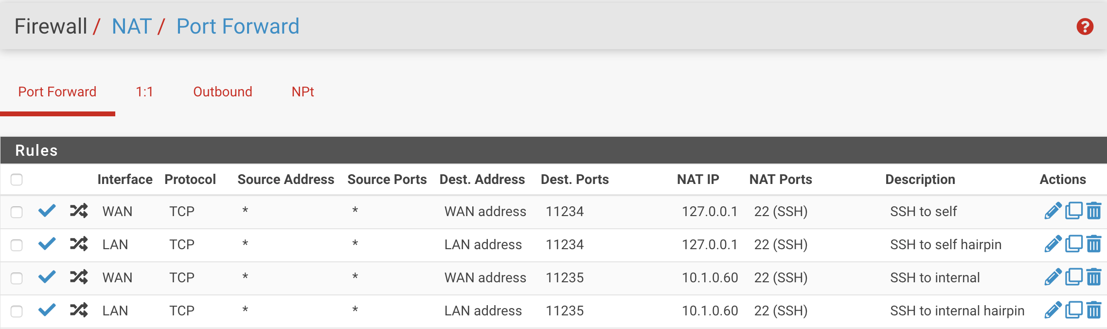

      I am having difficulty with inbound NAT port forward rules. I am aware of this thread and this issue, but I think this is a different problem, since I do not have an exotic WAN setup and some additional troubleshooting has also not worked.

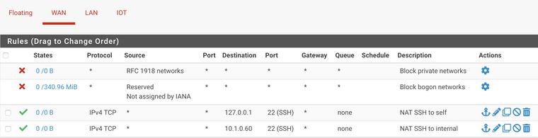

      I have the following rules to allow SSH to the router and to an internal server from outside:
      When I check the PF rule set, I see a few rules that confuse me:
      $ pfctl -sn | egrep '22|ssh'
      no nat on mvneta0.4091 inet proto tcp from (mvneta0.4091) to 10.1.0.1 port = ssh
      nat on mvneta0.4091 inet proto tcp from 10.1.0.0/24 to 10.1.0.1 port = ssh -> 10.1.0.1 port 1024:65535
      no nat on mvneta0.4091 inet proto tcp from (mvneta0.4091) to 10.1.0.60 port = ssh
      nat on mvneta0.4091 inet proto tcp from 10.1.0.0/24 to 10.1.0.60 port = ssh -> 10.1.0.1 port 1024:65535
      rdr on mvneta0.4091 inet proto tcp from any to 10.1.0.1 port = 11234 -> 10.1.0.1 port 22
      rdr on mvneta0.4091 inet proto tcp from any to 10.1.0.1 port = 11235 -> 10.1.0.60 port 22
      rdr on mvneta0.1102 inet proto tcp from any to 10.1.0.1 port = 11235 -> 10.1.0.60 port 22
      Why are there nat, no nat and rdr rules? The last rule is also concerning: rdr on mvneta0.1102 refers to a different VLAN, not the LAN interface, which is mvneta0.4091.
      I tried all the troubleshooting steps from the documentation:
      • recreating the rules didn't change anything
      • the firewall rules exist and are properly linked:
      • tcpdumps show the packets arriving at the WAN interface and do not see them exiting the LAN interface, indicating a problem within the router or firewall
      • firewall logs show the incoming packets being blocked by the default deny all rule
      I also tried adding a pass rule on the WAN interface for source *, sport *, destination self, dport 22, but external traffic to port 22 was still shown as dropped in the firewall logs by the default deny all rule. I really can't believe that this just didn't work.
      Additionally, the hairpin NAT rules appear to work fine: both ssh -p 11234 10.1.0.1 and ssh -p 11235 10.1.0.1 work and connect to the expected SSH servers.
      What's going on here?
