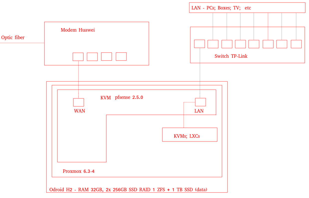

      This is the structure of my home LAN

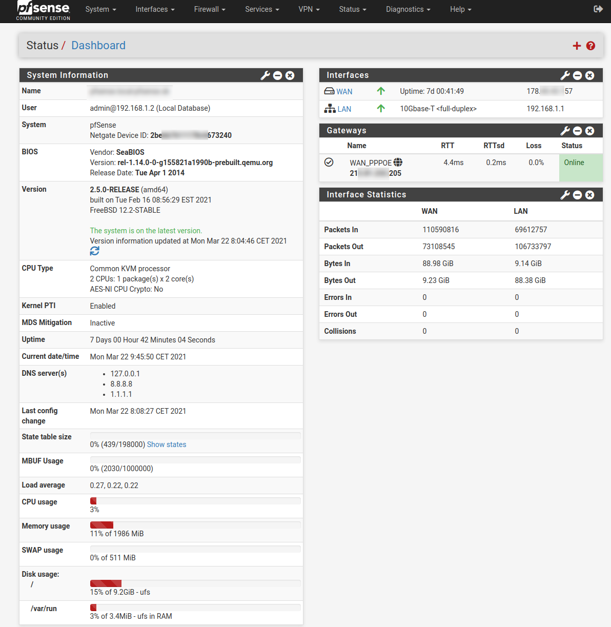

      pfsense dashboard shows that everything is fine

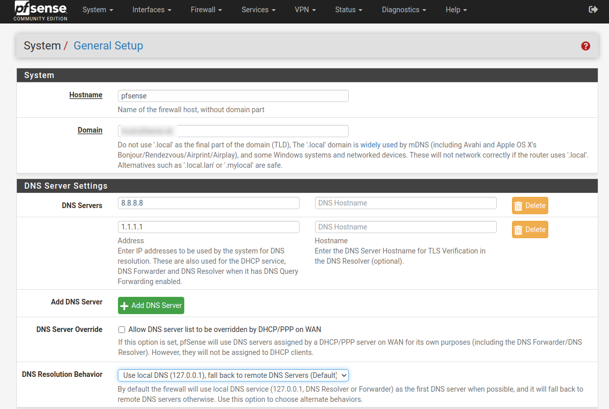

      I can't find the error, but I have a feeling the error will be in the DNS settings.

        You may try to remove these DNS Servers (1.1.1.1 and 8.8.8.8)
        from the configuration. Pfsense will reach out for the root servers then. This should work. If it doesnt, there may be a connection problem. You may use local DNS servers from yr ISP too.
