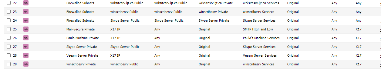

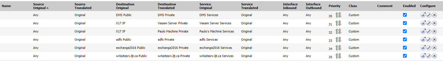

          this is how sonicwall sets up their NAT policies
          as you can see the NAT policies portion on PFSense is a lot more simpler and easier to use
          So yeah, when I'm trying to decipher what from sonicwall goes where on the pfsense, it gets garbled in my head

            @pjaneiro said in Switching from Sonicwall NSA 4600 to a pfsense box:
            You evoked memories in me (with the picture) ๐Ÿ˜‰

              @daddygo Hmm, not sure if I understand your post here, My post is about needing help trying to decipher what portions of the sonicwall nat rules are relevant to PFSense

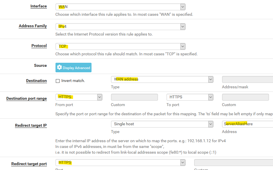

                        SteveITS Rebel Alliance @pjaneiro
                        Here's an example for HTTPS:
                        By default pfSense creates a firewall rule allowing the traffic ("Filter rule association" at the bottom of the page).
                        Upvote ๐Ÿ‘ helpful posts!

                            @steveits I'm looking at what you highlighted
                            And this is where I get really confused, All my rules and port forwarding are done
                            so my issue is what goes where here when I look at one set of my sonicwall rules for one of my services
                            this is where I do not quite grasp where what goes where
                            Since I do not transform my services (ports) I don't need worry about that
                            And I also know that rule that starts with firewalled subnets is the loopback rule, but that also confused the heck outta me, Is a loopback rule necessary for pfsense ?

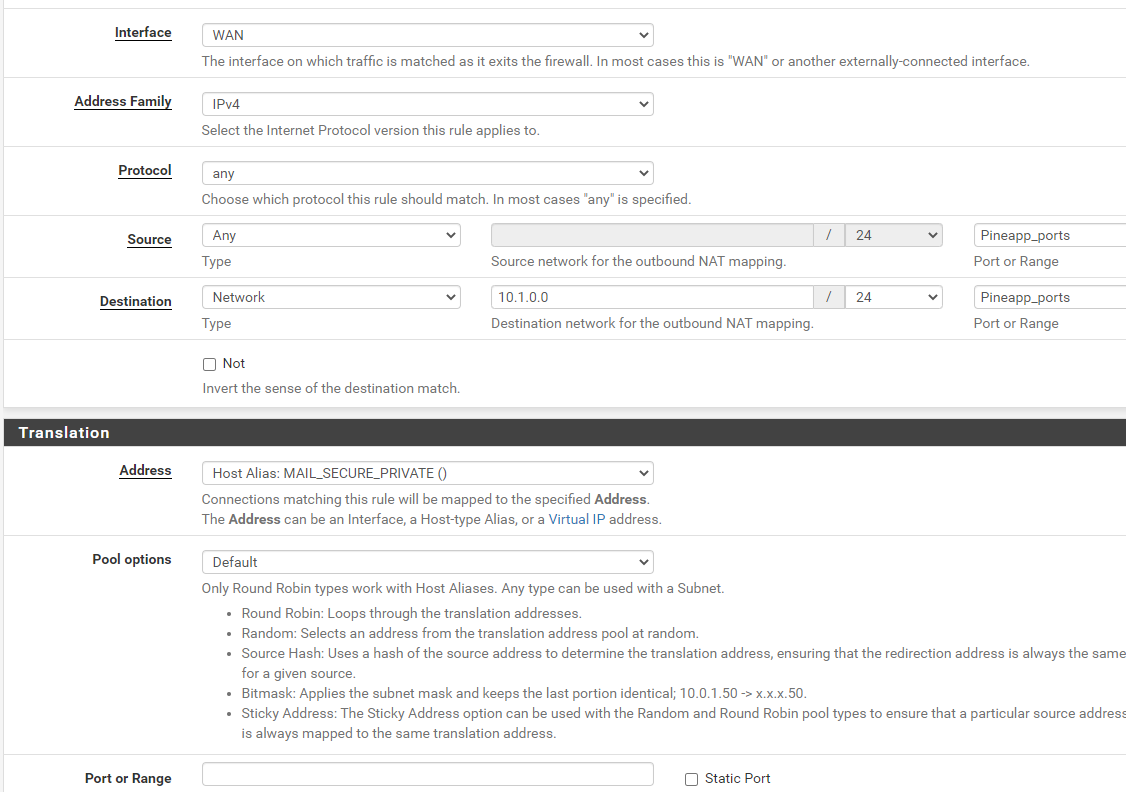

                              Are you trying for inbound NAT redirection (RouterWAN:443 -> WebServerLAN:443) or outbound NAT? Those are very different and your screen cap is for outbound. Outbound makes the outgoing packet use a different IP address, useful for instance if one has 1:1 NAT mapping and the outbound connection should use that IP not the default IP.

                                Basically I have about 40 ip wan adresses, let's say someone from the outside is hitting one of my public servers at 2.2.2.2, pfsense should know that when wan IP 2.2.2.2 receives a packet it should be redirected to internal private ip 10.1.1.1 and when private ip 10.1.1.1 answer back the outside world should see that 2.2.2.2 is answering and not my firewall that has an ip of 2.2.2.7
                                Am i writing this ok or did i screw the pooch i my explanation ?
                                  You're OK. So inbound would likely be 1:1 NAT then.
                                  Our setup is old, but for Outbound probably either Hybrid or Manual with a manual entry for each server:
                                  Source: 10.1.1.1/32
                                  Destination: any (the Internet)
                                  NAT Address: 2.2.2.2
