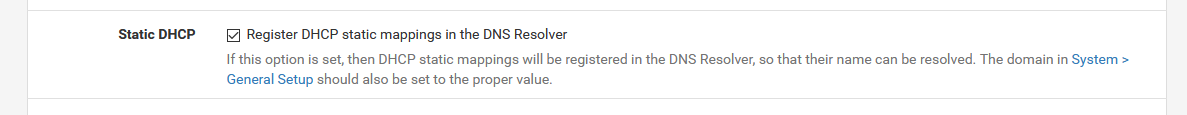

        This one does NOT restart unbound :
        as the Static MAC DHCP info is written to the system wide /etc/hosts file at the boot of pfSense, and after that that list doesn't change any more - they are 'static' ***.
        When unbound starts, it reads the /etc/hosts file.
        I advise to leave this option checked, so the host names will get used for the local DNS purposes.
