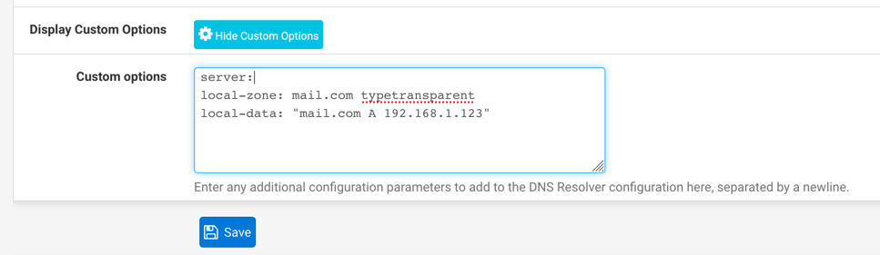

                      I see the resolver has the option to be run as "type transparent" overall, but there is no option to add local-data via the GUI. Would that be something I can submit as a new feature request?
                      DerelictD 1 Reply Last reply Reply Quote 0
                      • DerelictD Offline
                        Derelict LAYER 8 Netgate @lifeboy
                        Chattanooga, Tennessee, USA
