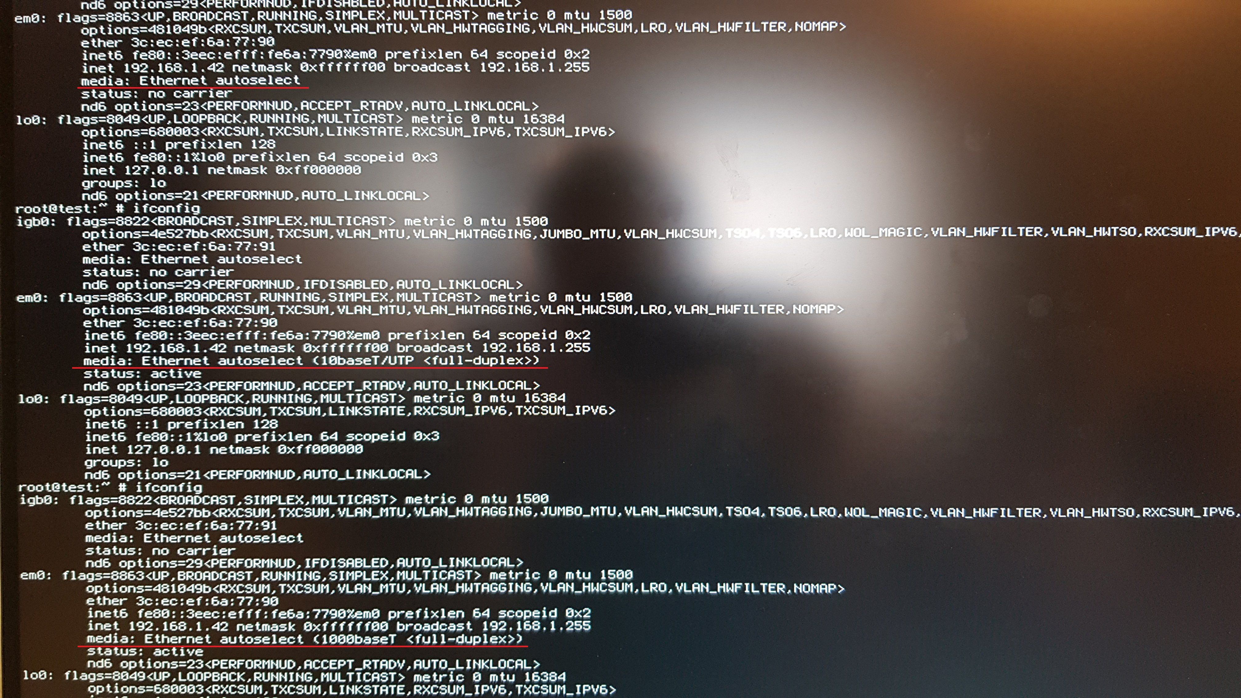

              FreeBSD Screen Shot:
              Before plugging in the LAN cord
              When the cord is plugged in
              I switch the LAN cord off and on again
