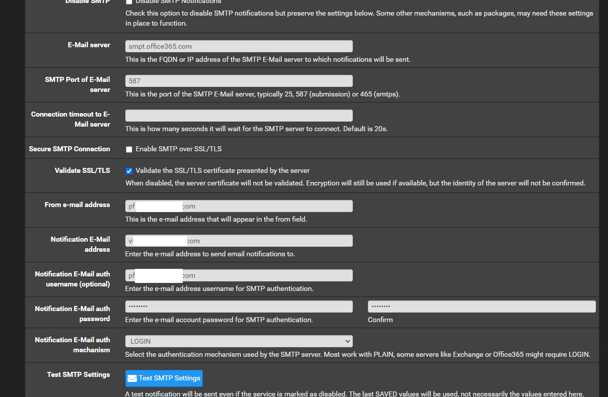

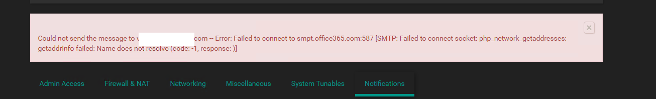

      I got 27 pfSense boxes, 4 of them fail SMTP. It happened after I updated sender email with the new one.

        1. Are those "sender email addresses" properly configured on the Office 365 side? 2. Are you using the same email on all 27 firewalls, or are they different among the firewalls?
        2. Are the 27 firewalls configured the same in terms of packages? If using something like pfBlocker or an IDS/IPS package, are the downloaded and active IP lists and rules exactly the same across the 27 firewalls?
        3. Make sure the time is correct on all the firewalls. A bad time/date on a firewall could cause issues with validating certs.
        And what is the exact error message you are getting back in return? If you can see the admin side of the Office365 account, have a look in there to see if the mail connection attempt is being rejected for some reason.

          serbus
          Hello!
          Check your "SMTP" server address...
          "smpt.office365.com" ?

            • bmeeksB Offline
              bmeeks
              You heard a slap against my forehead as well. I completely missed that typo when I reviewed the OP's screen capture the first time.

                • pfrickrollP Offline
                  pfrickroll @bmeeks
                  @bmeeks All firewalls have same configuration for SMTP but only 4 receive that particular error as shown in my screenshot. I have correct time on firewalls.
                  I am kind of new to Office365, I looked around in admin center in message center, mail flow and alerts but didn't find anything unusual and no trace of emails from those 4 firewalls. Where do I have to look specifically?
                  bmeeksB johnpozJ 2 Replies Last reply Reply Quote 0

                    Did you see the other replies in this thread? I failed to notice that you have misspelled the email server name. You typed "smpt" instead of "smtp" in the email host. Fix that and see if it then works.
                      johnpoz LAYER 8 Global Moderator @pfrickroll
                      @pfrickroll said in SMTP Email notifications fail in 4 out of 27 pfSenses:
                      No your never going to connect there.. Because its not smpt is its SMTP..
                      You have the wrong address..
                      Which is why its DOH!!

                        Like @johnpoz is saying, the error is on your pfSense firewalls (likely all 4 of them that are not working). Notice in your screen shot you posted in your original message that you have the Email Server name spelled wrong. You have "smpt.office365.com" and it should instead read "smtp.office365.com". You have the "t" and "p" backwards in the name.
