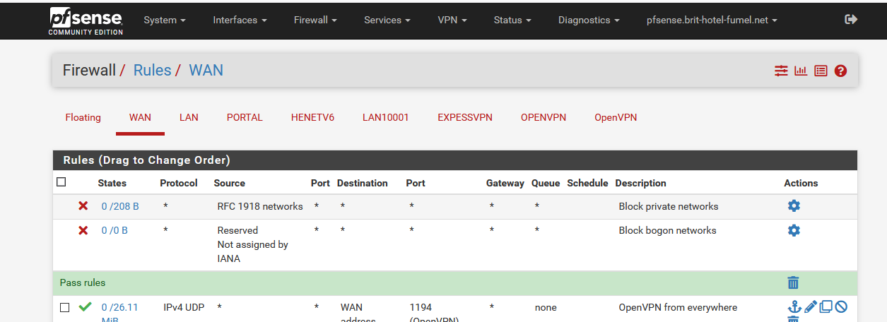

              You mean these :

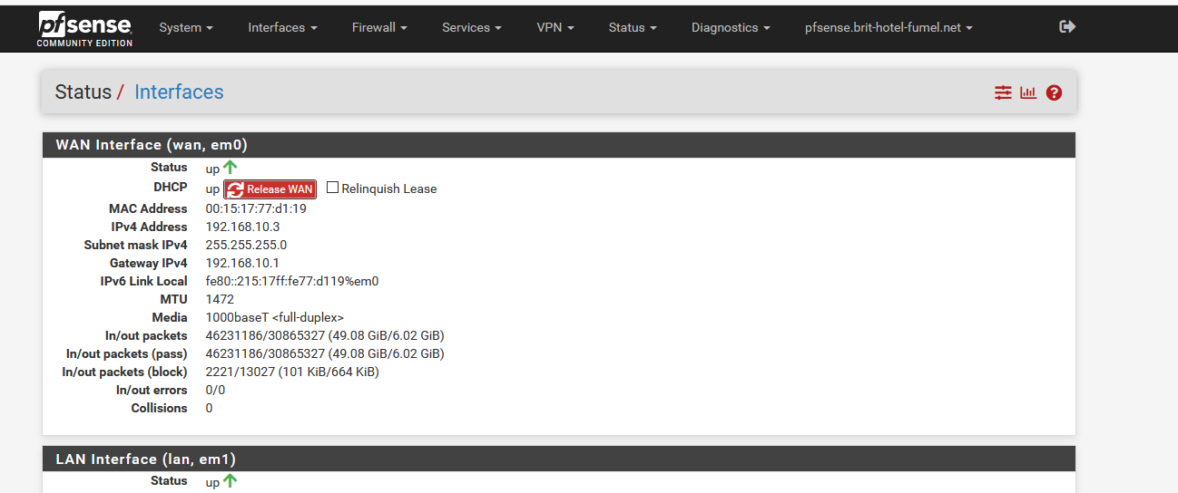

              This is my WAN :

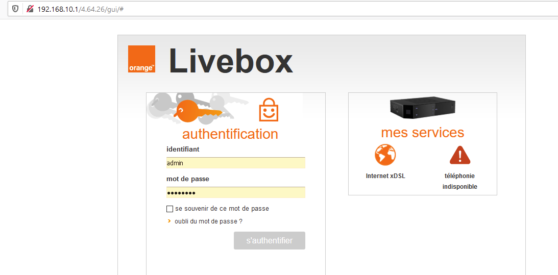

              pfSense has 192.168.10.3 and my ISP router's LAN IP is 192.168.10.1
              Still, when I type 192.168.10.1 in a browser situated on LAN, I can access my ISP router's GUI just fine.
              I didn't set any firewall or NAT rules for this to work.

                Notice that first rule, that blocks RFC 1918? You shouldn't have that if your WAN is 192.168.anything. The purpose of that rule is to keep anything within the RFC 1918 addresses from entering. Try disabling it and see what happens.
                UniFi AC-Lite access point
                GertjanG 1 Reply Last reply Reply Quote 1

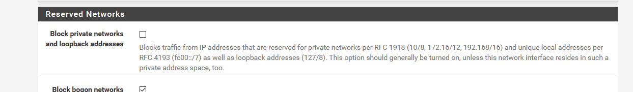

                  @jknott : I do agree with you - that rule - this rule :
                  should not be checked in my case.
                  As my upstream router has 192.168.10.1/24 == very RFC198.
                  I unchecked it, as per your words, and the description.
                  Still, nothing happens. No smoke, no sound.
                  I can still access my upstream ISP router (192.168.10.1) just fine :
                  This "Block private networks and loopback addresses" checkbox was like a no-op for me.
