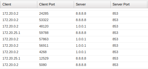

                  I am not sure how its doing, all I know is it IS doing it.
                  From pfsense:
                  From upstream router:
                  As you can see, its sending queries from both.

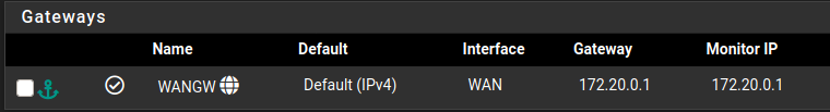

                        • E Offline
                          erasedhammer @johnpoz
                          @johnpoz
                          Heres the gateway list:
                          I don't have any internet static routes though, so everything gets sent to that default gateway.

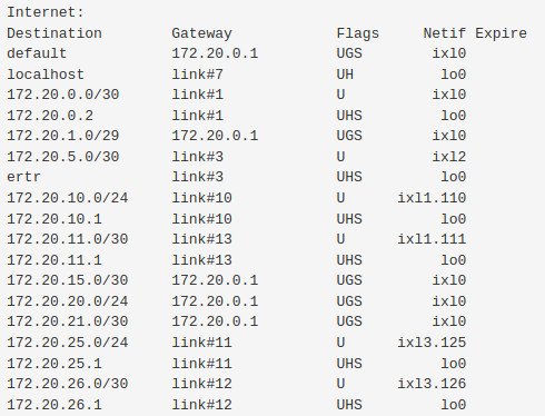

                            johnpoz LAYER 8 Global Moderator @erasedhammer
                            But lets see the routing table.. Pfsense shouldn't use the lan IP when it wants to talk to 172.20.0.1
                            It shouldn't be able to.. Makes no sense to use that IP when trying to talk to something that is not on that network.
                            • E Offline
                              @johnpoz
                              I don't see anything saying to use one of the lan interfaces to go to the internet
