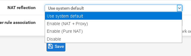

        The port forwarding does not work from inside, cause the NAT rule is defined on the WAN interface. So it only is applied to traffic coming in on WAN.
        If you want to access the public IP from inside you can enable NAT reflection in the NAT rule. If client and server are connected to the same network interface you might have to use "NAT + proxy" mode.
        If you use a host name to access the server, it's recommended to add a DNS override for it instead.

            @steveits said in Can't Hit Port Forward From Inside LAN:
            Also, in System/Advanced/Firewall & NAT ensure reflection is enabled in general.
            This enables NAT reflection globally, so that it's enabled by default in all NAT rules:
            Possibly that is not always desired and it's not necessary to enable it for a single forwarding rule.
