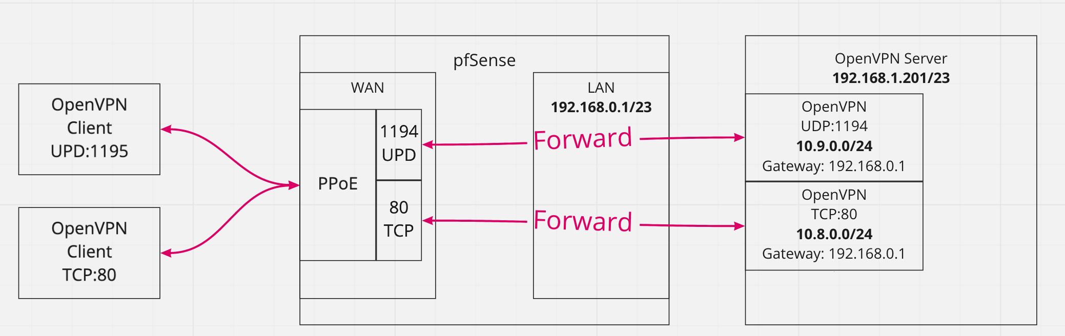

      All in all, got the setup going fine, but having some problems with my OpenVPN Server connections, where my VPN connected devices (OpenVPN Server running on a separate host in my network through port forwarding) can not connect to any internet hosts.
      See diagram for my setup:
      With the setup, I can connect to the OpenVPN Server(s) from the outside (UPD or TCP). When connected I can ping/http/ssh to any of the IP addresses in my LAN Address Space (192.168.0.0/23).
