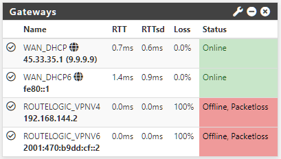

      I got the appliances and VLANs and in-hypervisor DMZs ready and lined up to hot swap them with the old setup when I noticed the new already-connected edge firewall, had the local end of a tunnel as the latter's gateway. This is a new topology, I still had a lot of loose ends with VLANs and rules I was also trying to maintain connectivity with conflicting addresses here and there, it was HARD. That address didn'tdoesn't make any sense. To be sure there were there were no other routes and this was in fact the gateway being used I started shutting down things but echo requests from deep inside the network at the local computer made it all the way and back but I was now so tired and confused that I kept second guessing what I was watching on screen.
      These are all the gateways:
      1 x ISP gateway (WAN_FIBER_PPPOE)
      1 x LAN static route (next stop is the reverse proxy, proxy4)
      1 x public VPN gateway (WAN_SURFSHARK_VPNV4)
      1 x private VPN gateway (WAN_CLOUDFRONT_VPNV4)
      The tunnel uses the network 192.168.144.0/24 (expanded from /30 to accomodate more clients while replacing the old). This is client-side, it should be 192.168.144.1, not .2. The RTT to the datacenter (~2200km/1300mi) of the other firewall is around 30ms, 0.2ms is impossible, even to my ISP or to the immediate device downstream the trip times are higher.
      I changed things on the remote side several times and reverted to backups but I couldn't make it report the correct gateway again, but it's nevertheless working for some reason. The gateway does make an appearance, briefly so, in the Routes section:
      That about it, it's also gone from the interface details:
      I tried setting the monitor IP using the correct gateway but it killed it:
      I'm thinking about switching to IKEv2 but it's so confusing when there's NAT. :/ Were there any changes in the software that I missed then got back with a clean image (I was using the betas earlier but the system merged back to stabled when it was released) or did I screw up my configuration plainly?

        I fixed it! Sort of...
        There was a OpenVPN client override. The address wasn't complete, I guess I must've missed it. I don't remember setting it at all though, maybe somebody else did.
        Upon restoring some areas from the old firewall the outbound NAT was restored without matching the gateway, so that was another problem.
