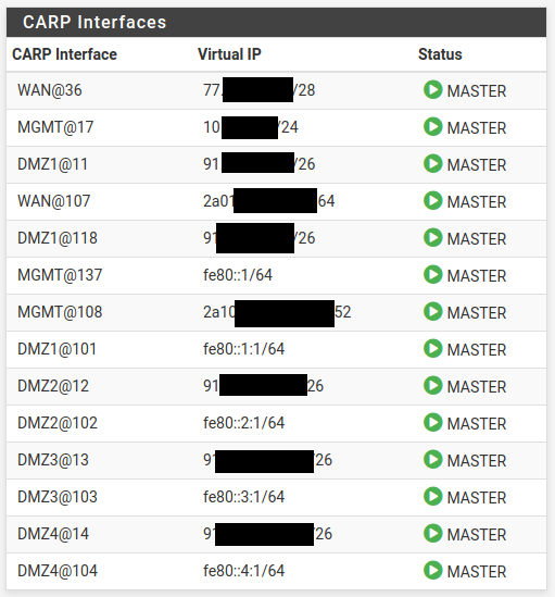

      What I want:
      I am setting up a Netgate XG-7100 HA Cluster for a small data center. We want to offer our clients Servers and VPS with a whole IPv6 /64 subnet for each server. I checked out how Hetzner is doing it and tried to implement their setup using pfsense.
      Hetzner gives you a whole IPv6 /64 subnet for your server and the default gateway is always fe80::1.
      What I tried:
      I configured one DMZ interface with a /52 subnet, so within that range i can have 4096 /64 subnets for up to 4096 clients, e.g. DMZ1 with static IPv6: 2001:db8:dc01:3000::1/52 and on the HA backup node i configured the same interface with IP 2001:db8:dc01:3000::2/52.
      After that I configured a CARP VIP for that interface: fe80::1/64.
      When I start servers on that network, I can configure them like:
      Server 1 IP: 2001:db8:dc01:3001::/64 (any bunch of IPs within that /64 block)
      GW: fe80::1
      Server 2 IP: 2001:db8:dc01:3002::/64 (any IPs within that range...)
      GW: fe80::1
      ... and so on ...
      With this setup verything works fine except HA. In case of powering off or rebooting the master node, the second node won't bring up the fe80::1/64 VIP.
      The Carp Status is initially reported fine on both nodes (Node 1: everything Master, Node 2: everything Backup) but after some time all Link-local VIPs change into INIT status on the second node.
