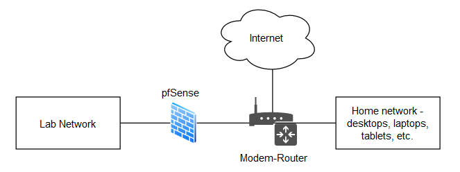

      I’ve been using pfSense on an old computer for use as a firewall between my lab network and home network. Circumstances mean that I will have to continue using my ISP router/modem for at least 6 months. The network looks like this (WAN on pfSense is configured as a static ipv4 address):
      This is not an ideal setup, however I will soon be moving and can re-do the entire network at that time; nonetheless, I need to replace my pfSense box with a Netgate appliance right away.

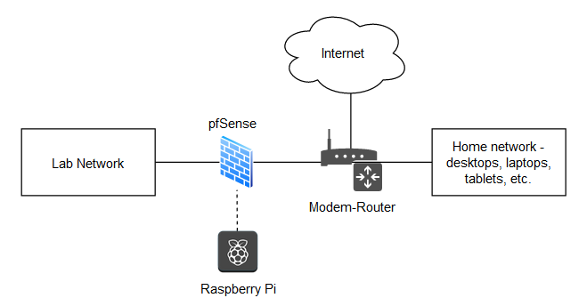

      I would like to experiment with port mirroring and had planned to add a Raspberry-Pi to the network like this:
      The Raspberry-Pi would analyze the traffic between the ISP router and Lab Network. I realize that pfSense can run Suricata, but I would like to use the Pi as shown in the diagram as a learning opportunity.

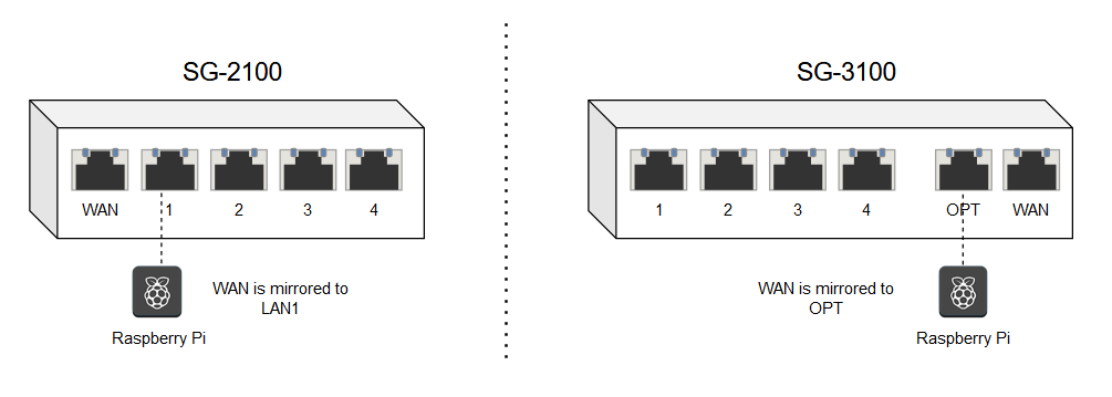

      Can the SG-2100 or SG-3100 support port mirroring? Could the WAN of either appliance be mirrored to LAN1 (in the SG-2100) or to OPT (in the SG-3100)?

        Don't you have a smart switch.. Even cheap <$40 smart switch would support mirroring or span.. And no span is not the same as stp..
        Off the top of my head, I wouldn't think 2100 or 3100 support span/mirror port. But I would think a "lab" has a smart/managed switch in it ;)
