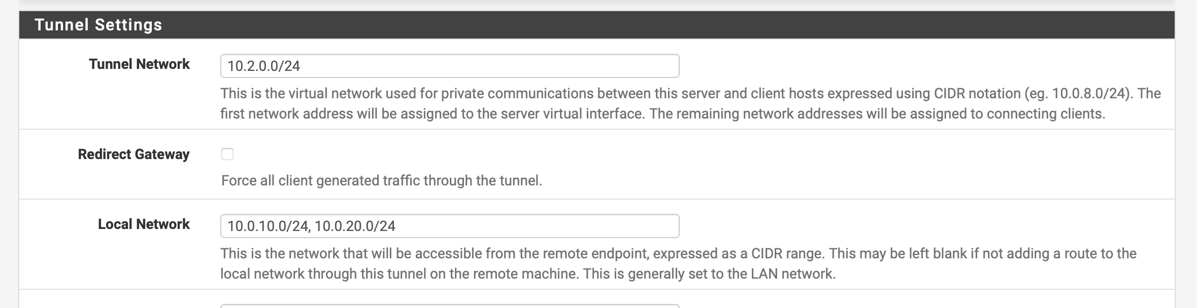

              Regarding Routing: So as pictured below, I want users connecting to this server to only access 10.0.10.0/24 and 10.0.20.0/24. But if I understand correctly; setting the local network in the server settings is just pushing the default route via the OPVN config... and can be overridden on the client side? So I'd need to add additional rules limited traffic from the tunnel networks to the VLAN networks as well?
                Search the web for adding routes to your OS. It's not difficult.
                No, you need a proper rule on the OpenVPN interface or OpenVPN tab. The latter one is an interface group indeed.
                Users who connect to the vpn server get a virtual IP out of the tunnel network. Since you're are running two servers with different tunnel networks you can use latter to restrict the respective users.
                E.g. server1 use 10.2.0.0/24, server2 10.3.0.0/24. So you can add rules to allow the source 10.2.0.0/24 access to VLAN10 and another to allow 10.3.0.0/24 access to VLAN15.

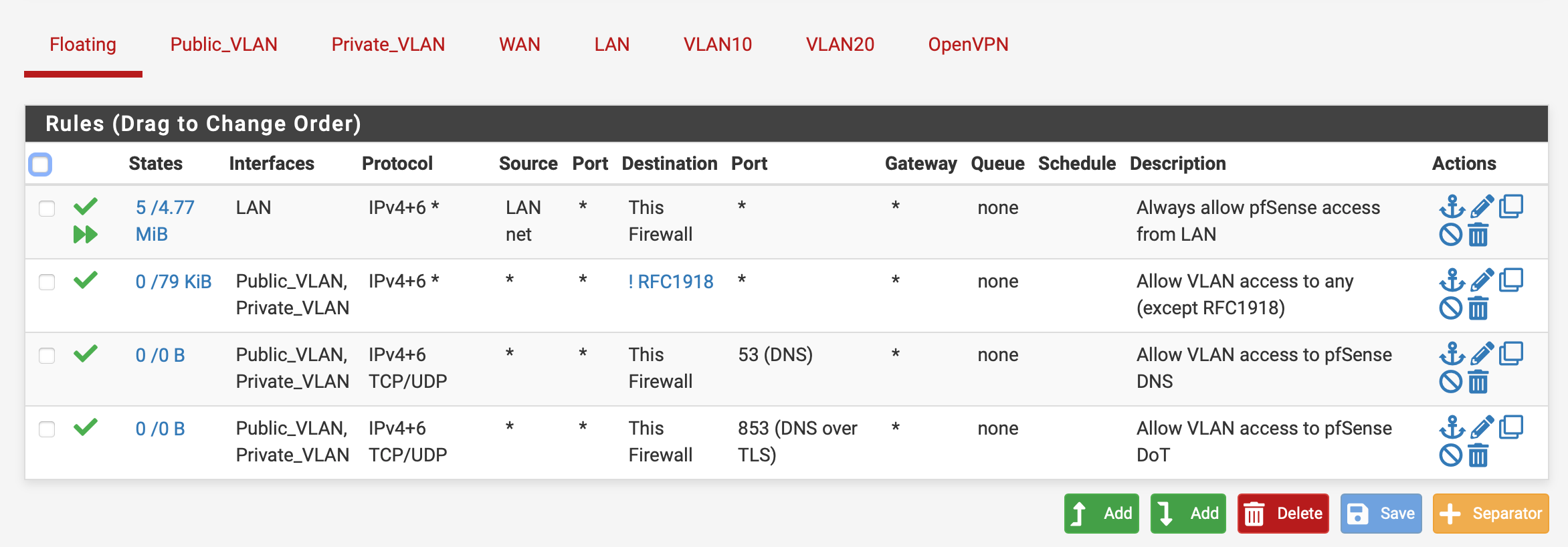

                  I'm using an interface group for VLANs to apply a rule that allows traffic to all except RFC1918 to isolate traffic. This seems to be working, but is that the wrong way to go about it too?
