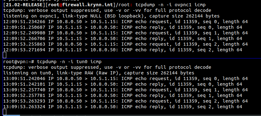

      I've got my sg-1100 configured as an OpenVPN client connecting to a server in a data centre. The VPN connection starts OK and from the pfSense shell I can ping the server side of the VPN and other hosts on the remote network so I know that the connection is fine. The top half here is local pfSense client, the bottom the VPN server
      The problem I've got is when hosts on my local LAN try to access hosts on the other side, I can see traffic entering the tunnel but it doesn't come out the other side.

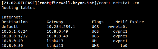

      The route appears to be in place correctly.

              @viragomann The bottom of the second screenshot is the VPN side of the tunnel, nothing is coming out of it. The top is the pfSense box, I see the ICMP packet coming in from the LAN with the destination of a host on the VPN side. I could be looking at completely the wrong thing, but I would expect the traffic to exit the VPN through tun0 even if they then disappear and don't get routed back.

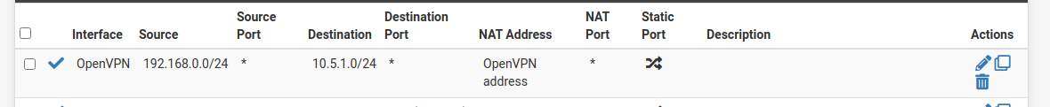

                @digininja99 That was it, I've just added this rule on NAT and all is working.

                    @viragomann What I'm trying to understand is why I don't see the packets coming out of the tunnel on the VPN side and then getting lost. If that box didn't have a route back, wouldn't the ICMP requests come out, and then the responses get routed out of the default gateway?

                        I agree that if the server side was missing the route back, it wouldn't know what to do with the traffic and how to send it back, but the key bit I'm not getting is that shouldn't I see that traffic emerging from the tunnel on the VPN side, the bottom tcpdump on the second screenshot. I fully get why I don't see any traffic coming back into pfSense from the VPN side, because no traffic is sent back, but I don't get why I don't see the ICMP requests that go in on the top of the screenshot come out on the bottom. Where does that traffic go?
                        I'm sure you are right with what you are saying, I just want to know where the packets go missing. I thought that if they went into a tunnel they would come out the other side, even if they then got lost and the next hop sent them the wrong direction and out the wrong gateway.
