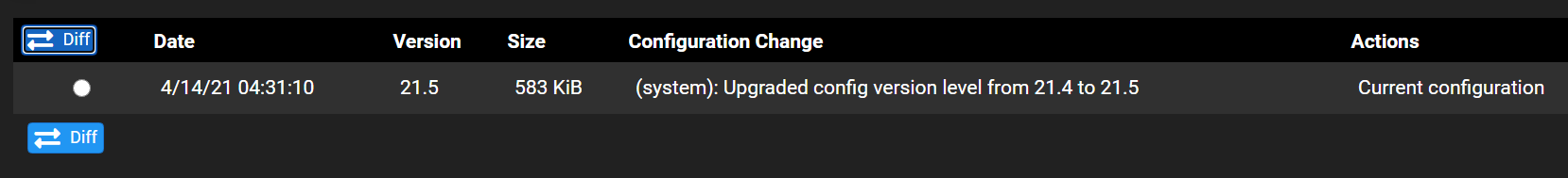

      I don’t know if I’d call this a bug as such but I noticed after updating from 2.5.0 to 2.5.1 that the last snapshot in backup and restore says that in the description that I’ve updated to 21.02.2. I can post an image later if required.

                @jimbo123 said in Backup and restore snapshot description is incorrect.:
                I'm curious to see a screenshot of that. I updated several CE and Plus systems here but didn't see that on any of them.

                  @jimp I updated fairly late last night and must have just seen 21.x and made the mistake of thinking it said 21.02.2 as that's the current latest FE release. I'm showing the same 21.4 to 21.5 version change as @provels.
                  I've attached a screenshot anyway.
                  • jimpJ Offline
                    OK, that is normal and it's the internal config revision number which is different than the release version.
                    You can see the config revisions for each version in the list at https://docs.netgate.com/pfsense/en/latest/releases/versions.html
