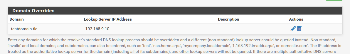

        johnpoz LAYER 8 Global Moderator @Dicmo
        I have not seen this, and just tested with 21.02.2 and works fine here..
        What are you putting in for a domain override?
        here is what I tested with.
