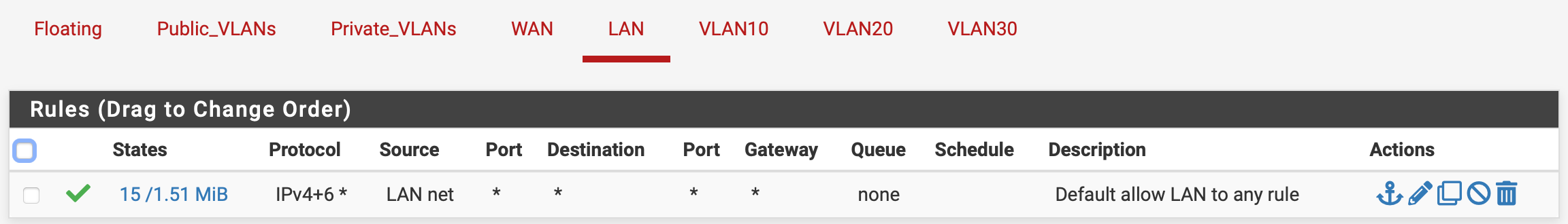

      LAN Interface: I have a LAN net -> ANY rule, allowing access to the net and all VLANs from the LAN. I suppose it would be more secure to only allow LAN to the internet by default, however, this network is in a data center and only has management nodes connected to it...

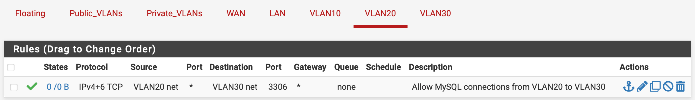

      Finally, I have a rule on VLAN20 to allow VLAN20 net over 3306 -> VLAN30 net for MySQL connections...

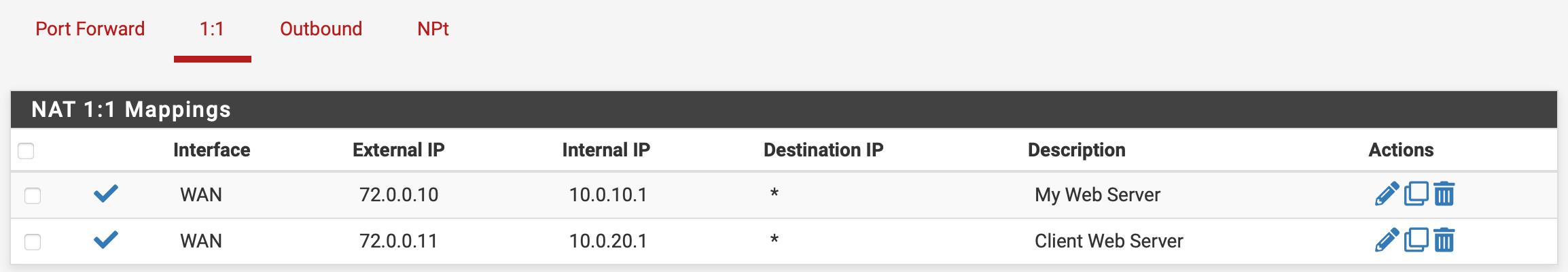

      Virtual IPs are setup using 1:1 NAT, and then rules defined on WAN to allow traffic as needed...
