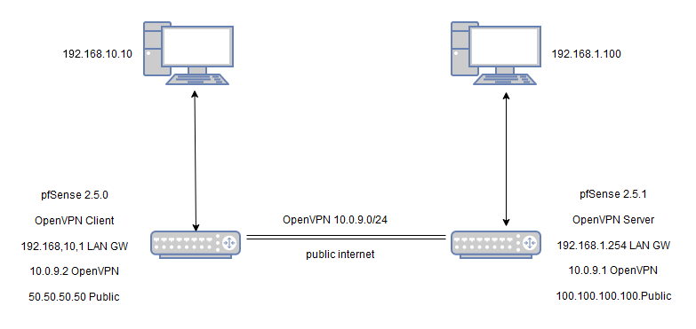

      New OpenVPN setup. Tunnel is up.
      I can ping between: LAN and local VPN GWs (remote and local).
      I can not ping remote LAN GW from local LAN GW.
      This seem like a routing issue to me.
      Both sides have an OpenVPN Rule to allow IPv4 * from/to *
      Routing on both sides seems correct to me.
      Would someone please look over my specs, to spot what I'm doing wrong?

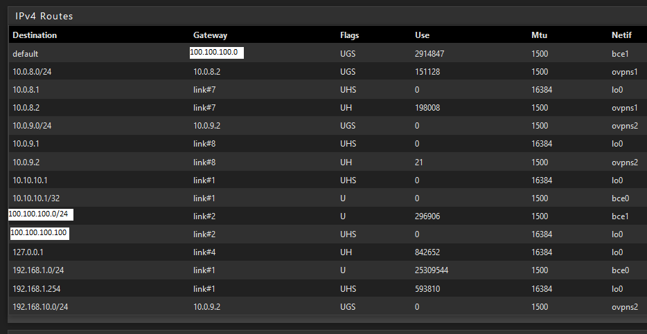

      Server Routes
      server routes

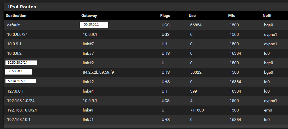

      Remote config:

      Remote routes:
      alt text

      Topology:
      alt text
      To clarify:
      From 192.168.10.1, I can ping 10.0.9.2 and 10.0.9.1 but not 192.168.1.254
      From 192.168.1.254, I can ping 10.0.9.1 and 10.0.9.1 but not 192.168.10.1
