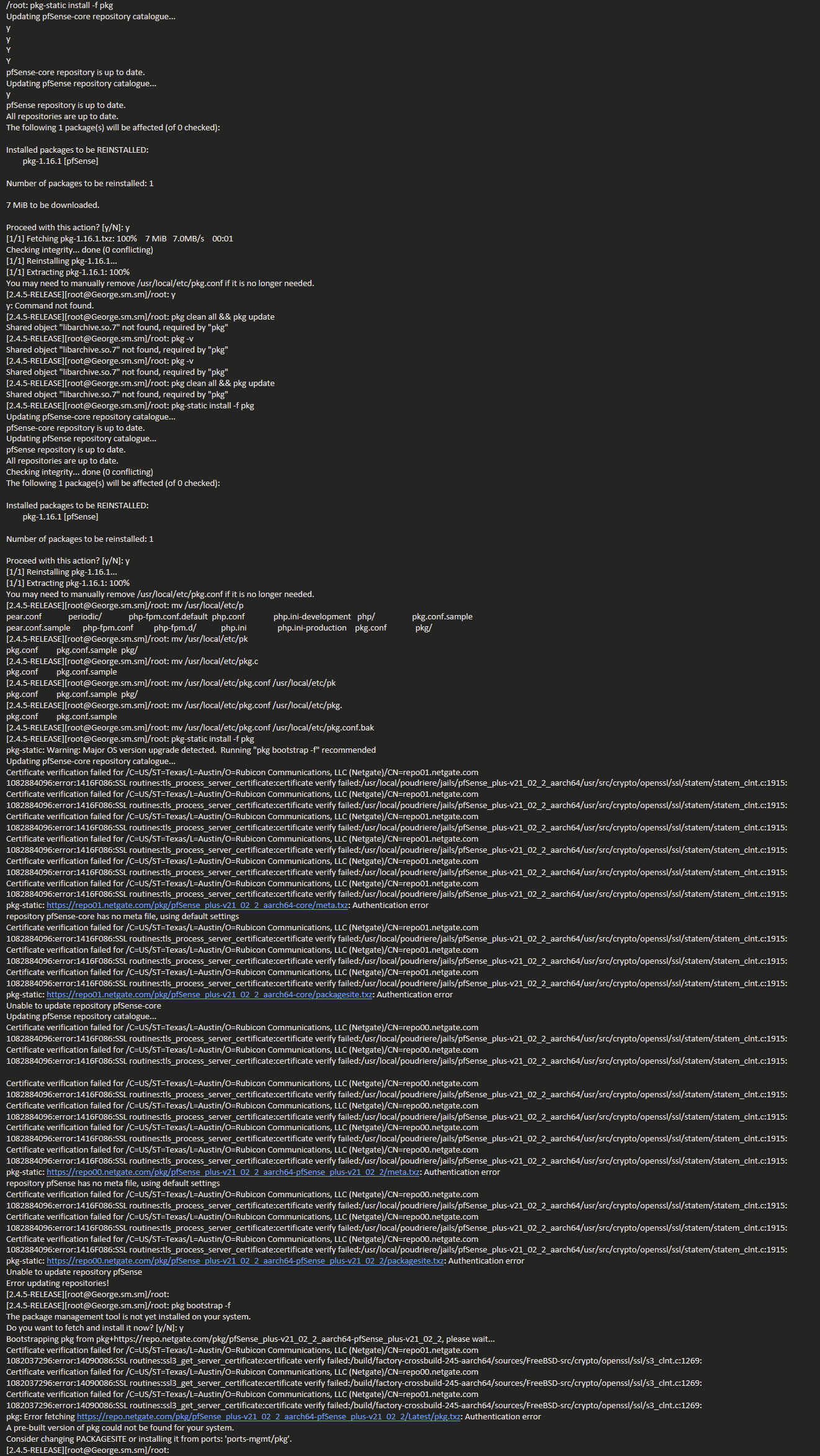

    Stuck upgrade left pkg unusable on SG-1100
    5 Posts 2 Posters 1.1k Views 2 Watching
    • maphilli14M
      maphilli14
      I was on 2.4.5 or 2.4.5p1 (I didn't write it down) I started the 21.02.x upgrade, it did the full 115mb 195 step/package download and rebooted as described in the docs. I had a console on the whole time to catch the logs if needed I have them saved. After coming back on line I found a non 21.x version but rather
      [2.4.5-RELEASE][root@
      What is problematic is that I can't always get back to the system update in the gui and when going into CLI I find this:
      /root: pkg clean all && pkg update
      Shared object "libarchive.so.7" not found, required by "pkg"
      I rebooted manually and tried several other options after searching none fixed
      ![24e9b77a-0159-43bf-bb78-4318e01864f1-image.png](/assets/uploads/files/1618926518021-24e9b77a-0159-43bf-bb78-4318e01864f1-image.png)
      /root: pkg-static install -f pkg
      y
      y
      Y
      Y
      y
      The following 1 package(s) will be affected (of 0 checked):
      Installed packages to be REINSTALLED:
              pkg-1.16.1 [pfSense]
      Number of packages to be reinstalled: 1
      7 MiB to be downloaded.
      Proceed with this action? [y/N]: y
      [1/1] Fetching pkg-1.16.1.txz: 100%    7 MiB   7.0MB/s    00:01
      [1/1] Reinstalling pkg-1.16.1...
      [1/1] Extracting pkg-1.16.1: 100%
      You may need to manually remove /usr/local/etc/pkg.conf if it is no longer needed.
      [2.4.5-RELEASE][root@George.sm.sm]/root: y
      y: Command not found.
      [2.4.5-RELEASE][root@George.sm.sm]/root: pkg clean all && pkg update
      [2.4.5-RELEASE][root@George.sm.sm]/root: pkg -v
      [2.4.5-RELEASE][root@George.sm.sm]/root: pkg-static install -f pkg
      [2.4.5-RELEASE][root@George.sm.sm]/root: mv /usr/local/etc/p
      pear.conf             periodic/             php-fpm.conf.default  php.conf              php.ini-development   php/                  pkg.conf.sample
      pear.conf.sample      php-fpm.conf          php-fpm.d/            php.ini               php.ini-production    pkg.conf              pkg/
      [2.4.5-RELEASE][root@George.sm.sm]/root: mv /usr/local/etc/pk
      pkg.conf         pkg.conf.sample  pkg/
      [2.4.5-RELEASE][root@George.sm.sm]/root: mv /usr/local/etc/pkg.c
      [2.4.5-RELEASE][root@George.sm.sm]/root: mv /usr/local/etc/pkg.conf /usr/local/etc/pk
      [2.4.5-RELEASE][root@George.sm.sm]/root: mv /usr/local/etc/pkg.conf /usr/local/etc/pkg.
      [2.4.5-RELEASE][root@George.sm.sm]/root: mv /usr/local/etc/pkg.conf /usr/local/etc/pkg.conf.bak
      pkg-static: Warning: Major OS version upgrade detected.  Running "pkg bootstrap -f" recommended
      Certificate verification failed for /C=US/ST=Texas/L=Austin/O=Rubicon Communications, LLC (Netgate)/CN=repo01.netgate.com
      1082884096:error:1416F086:SSL routines:tls_process_server_certificate:certificate verify failed:/usr/local/poudriere/jails/pfSense_plus-v21_02_2_aarch64/usr/src/crypto/openssl/ssl/statem/statem_clnt.c:1915:
      pkg-static: https://repo01.netgate.com/pkg/pfSense_plus-v21_02_2_aarch64-core/meta.txz: Authentication error
      repository pfSense-core has no meta file, using default settings
      pkg-static: https://repo01.netgate.com/pkg/pfSense_plus-v21_02_2_aarch64-core/packagesite.txz: Authentication error
      Unable to update repository pfSense-core
      Certificate verification failed for /C=US/ST=Texas/L=Austin/O=Rubicon Communications, LLC (Netgate)/CN=repo00.netgate.com
      pkg-static: https://repo00.netgate.com/pkg/pfSense_plus-v21_02_2_aarch64-pfSense_plus-v21_02_2/meta.txz: Authentication error
      repository pfSense has no meta file, using default settings
      pkg-static: https://repo00.netgate.com/pkg/pfSense_plus-v21_02_2_aarch64-pfSense_plus-v21_02_2/packagesite.txz: Authentication error
      Error updating repositories!
      [2.4.5-RELEASE][root@George.sm.sm]/root: pkg bootstrap -f
      The package management tool is not yet installed on your system.
      Do you want to fetch and install it now? [y/N]: y
      Bootstrapping pkg from pkg+https://repo.netgate.com/pkg/pfSense_plus-v21_02_2_aarch64-pfSense_plus-v21_02_2, please wait...
      1082037296:error:14090086:SSL routines:ssl3_get_server_certificate:certificate verify failed:/build/factory-crossbuild-245-aarch64/sources/FreeBSD-src/crypto/openssl/ssl/s3_clnt.c:1269:
      pkg: Error fetching https://repo.netgate.com/pkg/pfSense_plus-v21_02_2_aarch64-pfSense_plus-v21_02_2/Latest/pkg.txz: Authentication error
      A pre-built version of pkg could not be found for your system.
      Consider changing PACKAGESITE or installing it from ports: 'ports-mgmt/pkg'.
      I do have a backup of the config and am willing to do a 'fresh install' but not sure if this is the right thing to do yet or not, please help!
      TIA,
      Mike

        @maphilli14 Probably faster to get a fresh 2.5 image from Netgate Support and install that then restore your config than to try and debug this.

          @kom just open a case at go.netgate.com?

            @maphilli14 said in Stuck upgrade left pkg unusable on SG-1100:
            go.netgate.com
            That should work. Make sure you have your Netgate Device ID handy.

              maphilli14 @KOM
              @kom I do, thank you!!!
