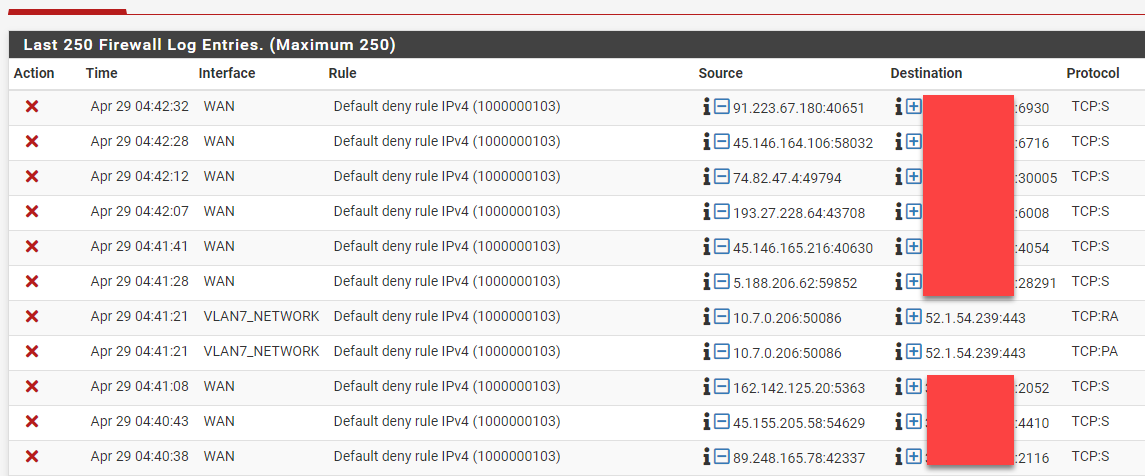

      Good Moring.
      Almost everyday my firewall stops routing to the internet. If I enable or disable PfBlocker the Internet works. If I change my PC to use google DNS it works. If I reboot the firewall it works. If I just save DNS resolver and apply changes, even though I made no change it works. I see nothing in the firewall that suggests I'm being blocked. It's driving me crazy and any assistance would be appreciated.
      31e75e3a-3c33-496e-8020-b51886b4da93-image.png 1a4caea9-1bbb-42cb-8f4d-c6540306dead-image.png

                        As indicated in my first post I can ping DNS address if I change my PC to not use the firewall DNS when the issue is occurring. I can ping 8.8.8.8 from pfsense but not goggle.com.
                        I don't understand why pfsense is running and it stops routing to the internet, why I can change the DNS of my PC to go around pfsense DNS and the reason why I'm asking for assistance. What should I do to troubleshoot unbound when it's having this issue? Is there a log to see when and at what point does unbound crash and why is it crashing?
