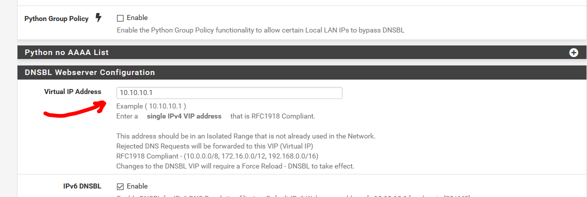

          You're not using pfBlockerNG, right ?
          Because, if so, this default pfBlockerNG setting will conflict :
