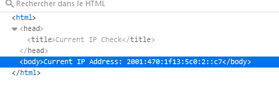

        I've been trying to create my own 'IP check page', as it should be https these days :
        I created a
        https://my-domain.tld/whatismyip.php
        that returns a :
        But, as usuall, I thought I understood everything without redaing the manual.
        As usual, I was wrong - because ignorant.
        Actually, you should look one level lower- the html : It should return :
        Look also here Add support for non-Oracle IP Check providers
        => adding your own or other IP test sites with a 'regex'.
