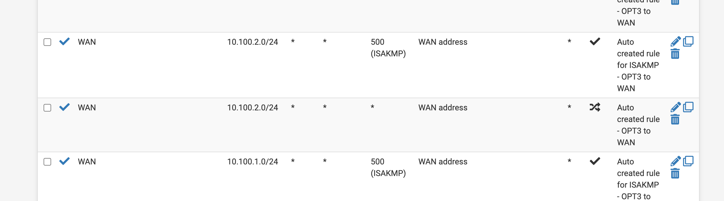

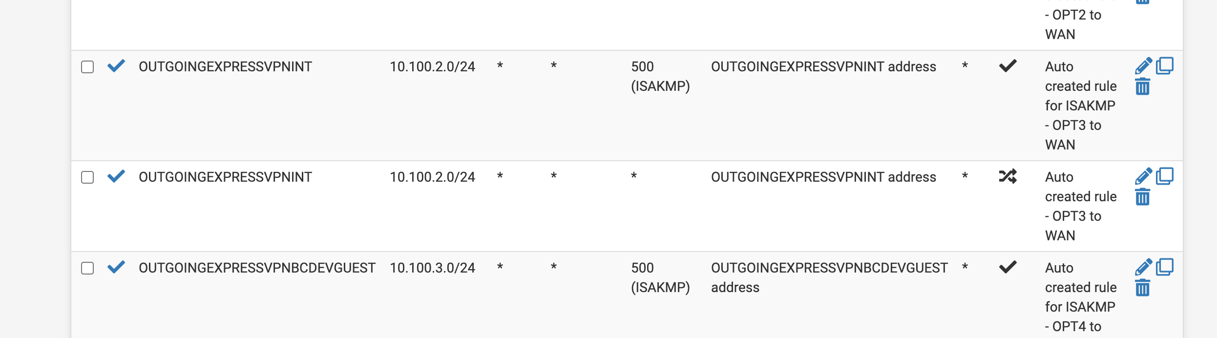

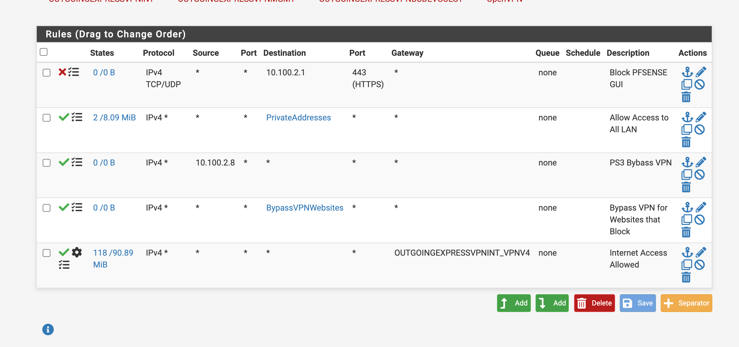

These are the outgoing NAT rules and the Firewall rules for the Internal network. From now on I'll just post stuff specific to that network for trying to get this figured out. I'm assuming that whatever is wrong with it will be the same thing wrong with the others.

@crackerjackshot That all looks good to me, and like you've said it used to work. You said you could ping the other end of the tunnel but the trace only shows the requests and not the replies. Your graphs appear to show only tunnel overhead traffic. Can a client on the 10.100.2.0 network ping 8.8.8.8?
@kom Yes it can. I have full internet on that subnet. I'm even at work right now (though I've accidentally cut it off a couple of times trying some fixes) on that subnet. The only problem being that it is being routed around the VPN tunnel.

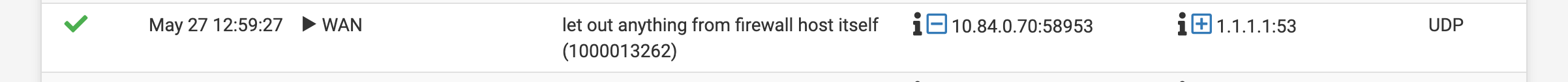

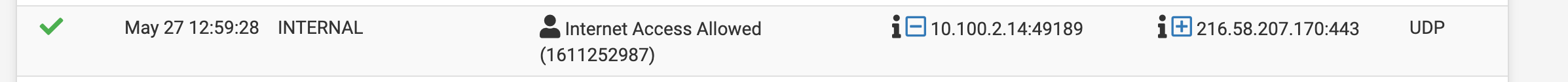

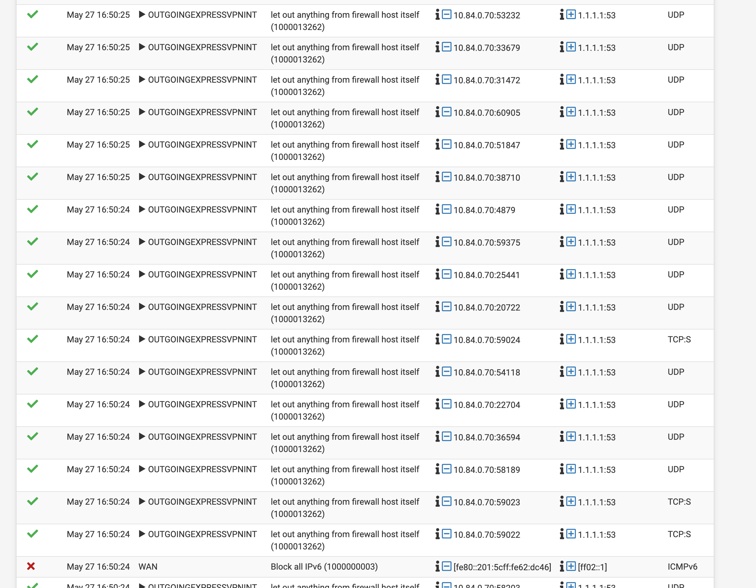

These two screenshots show the firewall logging the first one showing that it's being let out through the rule that should be doing the VPN pipe. Normally the second rule is the VPN address as the source, but it shows the let out anything from firewall host itself and then src is my real IP.
And there is an example of the DNS being routed out the VPN tunnel. And I've double checked that with DNS leak tests and seen that the IP is coming from the VPN, but the site knows my IP because of the 443 traffic.

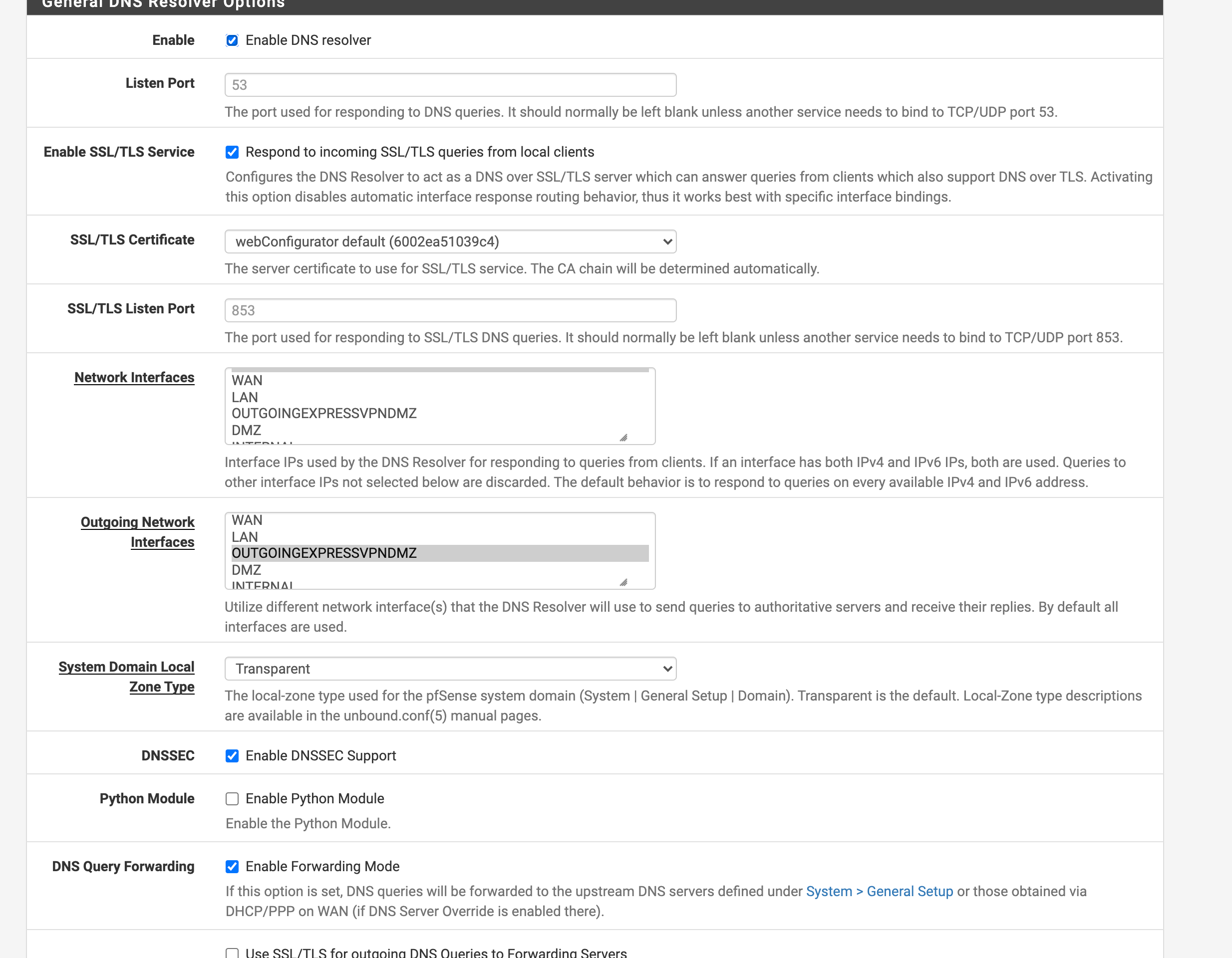

@crackerjackshot You have Resolver's outgoing network interface set to the VPN?
@kom Correct.

Now one last thing that I'd like some input on that maybe you know what this is. I have been noticing lately that every once in a while a get these massive dumps of DNS requests that look like they just originate from the firewall itself.
That isn't normal is it?
@crackerjackshot
This is a completely other source IP as the OpenVPN clients IP shown in the capture above. If it is not your VPN interface IP something is wrong in your outbound NAT or these DNS requests are accidentally bypassed the resolver and have no outbound NAT rule.Anyway, if this is not your clients internal VPN IP the DNS requests won't succeed, hence the client tries again. This explains why there are clusters of requests.
@viragomann That IP is the address of the DMZ VPN connection, that is why it's different than the internal VPN connection IP. As I said in earlier parts of this thread I have all of the DNS piped out just the one DMZ connection. It seems to be working as my DNS gets resolved but that could be why that is happening. I can switch the resolver to go out "all" and see if that changes it.
