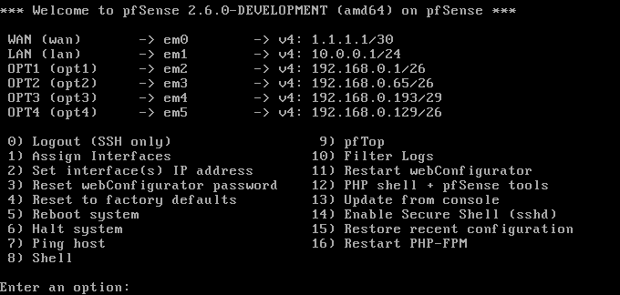

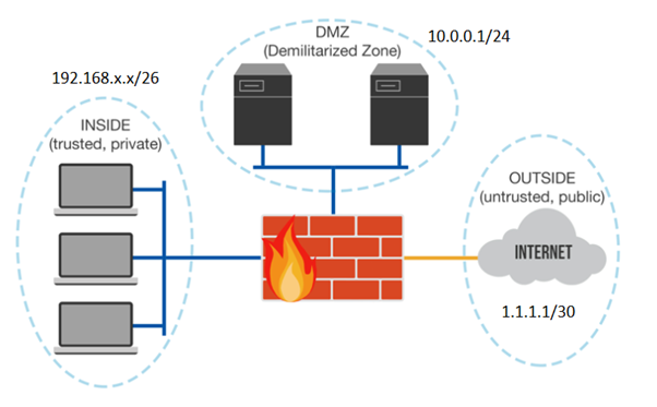

      Between these two machines, I am using PFSENSE-HP 2.6.0 as my router.

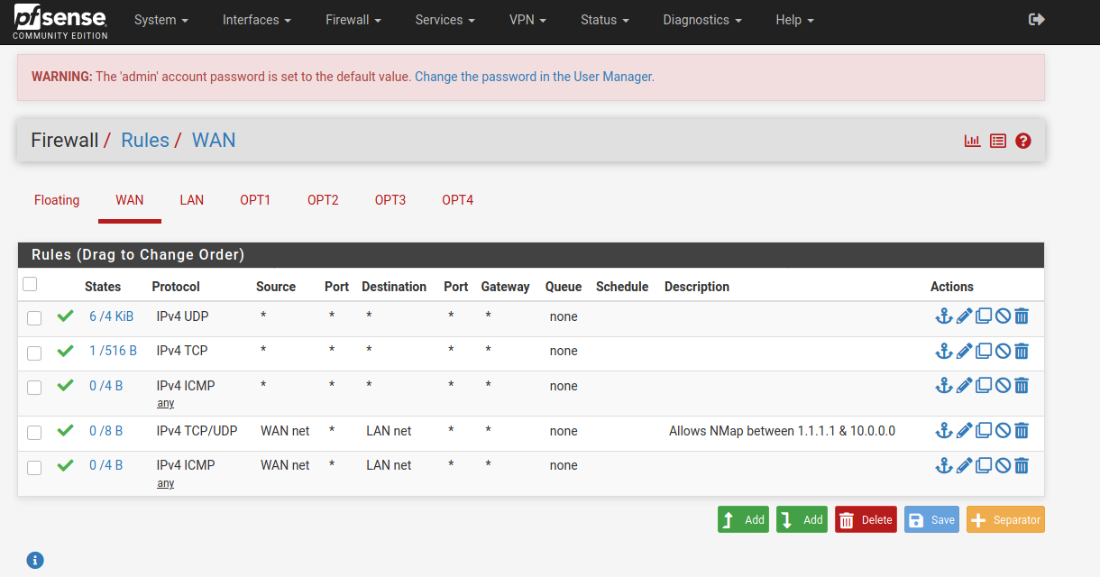

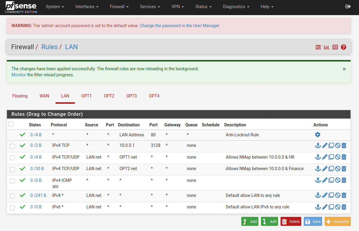

      The issue is that when I use the Bridged adapter on my Ubuntu machine, my Kali can't ping the IPv4 address of the Internal Network (DMZ) adapter anymore. However, I can access the website on 10.0.0.69 via my browser on Kali. In addition, I am able to ping the Ubuntu machine from a shell on my PFSENSE-HP router. To ensure that this isn't a firewall issue, I allowed all ICMP requests to flow from the External zone to the DMZ zone vice versa on the router. I also used iptables to make sure ICMP echo requests are not getting blocked on both the Ubuntu and Kali machines. What makes this even weirder is that, I can ping my Kali from my Ubuntu machine but not the other way round. The moment I remove the bridged adapter, the pings are able to work again. However, I really need the bridged adapter for gaining an internet connection on my Ubuntu machine. I just want to be able to get Internet connection but also be able to ping the network at the same time.

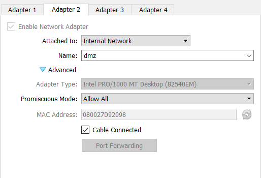

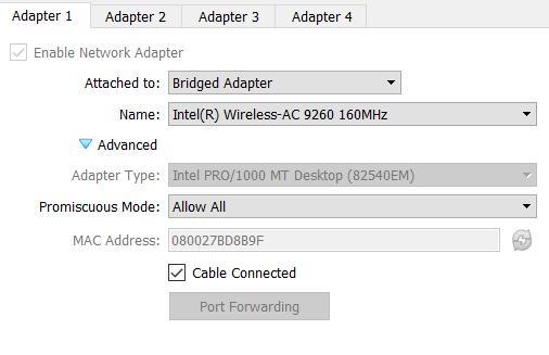

      PS. The following are my adapter settings on my Ubuntu machine. (Please let me know if I'm not giving enough details in this post) Thanks in advance!
      (My PFSENSE router is also a VM)
      I can access the website from my kali in the External zone via 10.0.0.69. However, I cannot ping it somehow, which to me, doesn't make sense. The moment I just remove the bridged adapter, everything starts working again. In addition, I have also tried NAT, but it doesn't give internet connection somehow, which is the reason why I resorted to using the bridged adapter.
      If it is of any help, the following are the .vbox files I am using.
      vbox.zip
      Edit: Just disconnecting the bridged adapter (in my case enp0s3) fixes the issue, I don't have to reboot the machine or anything and the ping will go through.

          @gertjan Oh, sorry for the misunderstanding, 1.1.1.1/30 is my gateway for the external network. 1.1.1.2/30 is what I'm using to simulate a user from the Internet.
          Everything is just on my sandbox, I'm not touching noone

              Your rule wan net to lan net? When would that work? your wan net is a /30 so your allowing 1.1.1.1 only to talk to anything on the lan.. What would be generating this traffic into your lan? And whats the point of that rule anyway when you have allow any any rules above them?

                  @gertjan It is just my own sandbox network environment. And yes, WAN to LAN does work when I remove the bridged adapter. I am allowed to talk to the LAN, which in my case is simulating the DMZ where I host my webserver. I added in the rule, later on, to make sure that it allows ICMP to pass through, it was just to serve as a double-check.

                          @gertjan & @johnpoz I just had a discussion with my teacher. He mentioned that I should add another static route (NAT) from the PFSense router to the Internet, so based on this, I added an OPT5 interface to my router and tested it using an IP of 192.168.0.112/24. Is this the correct idea? Because it still doesn't work for me. Or is it because I have to add another WAN interface to the router?

                              For setting up a lab in vm tied to physical network(s) you would use bridge interface in vm network. This ties the vm to the physical world the host is connected to on that interface. If your vms do not need to be tied to physical world via an interface, and say route through pfsense vm to get to the real world. Then the vm network in that case would normally be host only networks.
