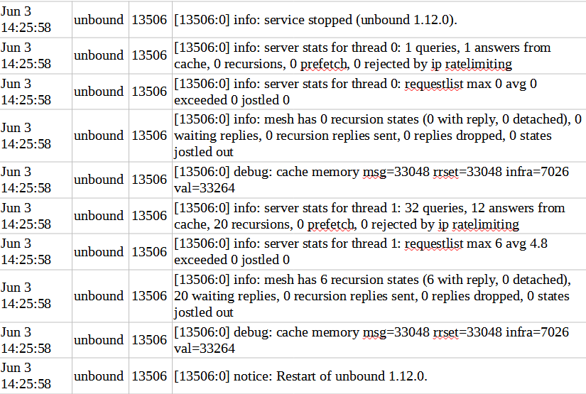

      On an sg-1100 running 21.05-RELEASE (arm64) (on FreeBSD 12.2-STABLE) I occasionally have the DNS service just...quit. Be forewarned, my DNS setup is a little convoluted, but wonder if this issue is actually unrelated to that. As you can see below, unbound seems to keep restarting every now and then. The log shows this being a regular thing, but here's just a sample:
      When I notice the DNS service drop out and go check logs, I see "notice: Restart of unbound 1.12.0." so I suspect this is either the cause (though I'm not sure how) or a symptom.

        Gertjan @CyberMinion
        @cyberminion said in DNS dies periodically (due to unbound crashing?):
        pfBlockerNG is running for both subnets
        pfBlockerNG can restart unbound regularly. Do a manual reload of pfBlockerNG and see for yourself.
        When DNS service drops out, I can wait about 20 minutes for it to come back by itself
        This is the real issue : it did not crash, it was just restarting, and this shouldn't take that long.
        Or it does so on your system.
        Bring your system back to default settings (remove or de activate pfBlockerNG and other packages) and add them back again step by step. Restart unbound with the GUI :
        and check with the unbound logs how long it took.
        Do this for each step, each feed you add to pfBlockerNG.
        The Firewall > pfBlockerNG > Update : Reload > All
        also shows you how much time it took for unbound to restart :
