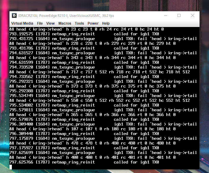

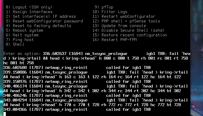

      Crash after opening Steam

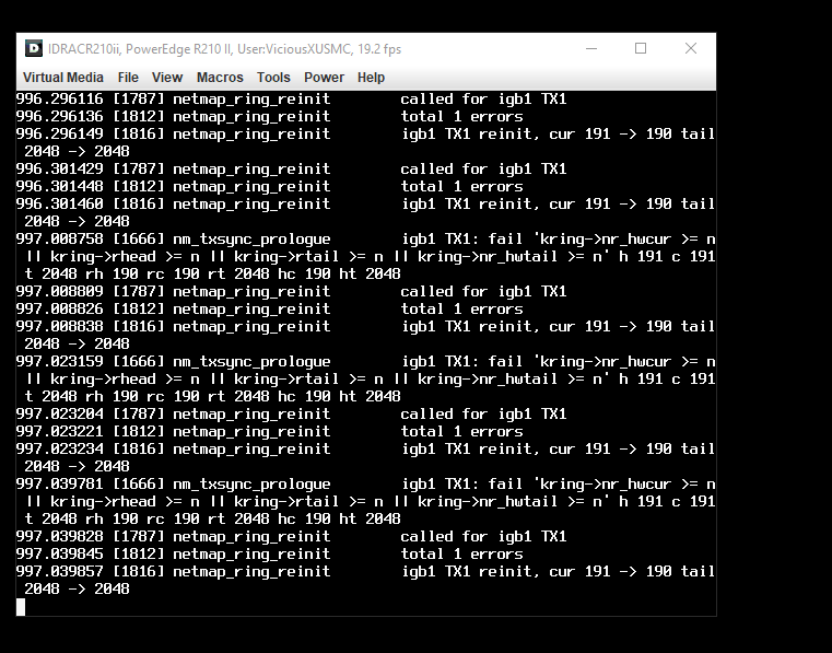

      Changed Netmap to Emulated Mode using dev.netmap.admode=2 still crashed but looked different and my uploads went to garbage.

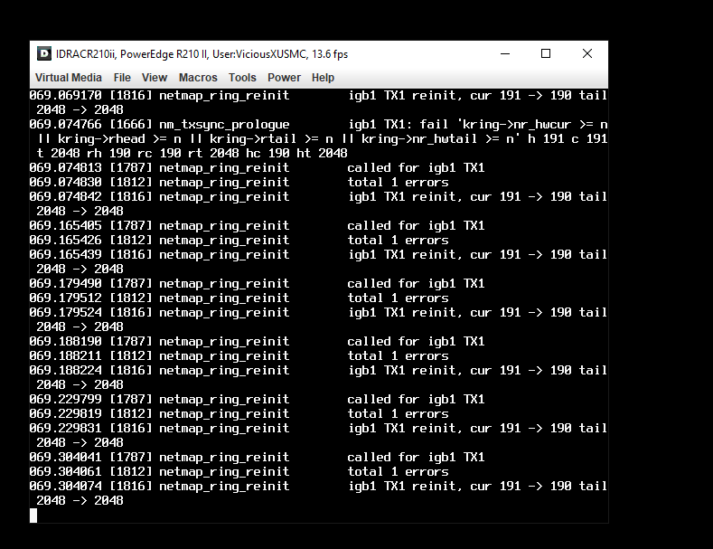

      And last here is running a speedtest, errors but did not crash. When its in a crash state these move so fast you cant see anything. I am also not sure if there is any recovery short of a reboot.
