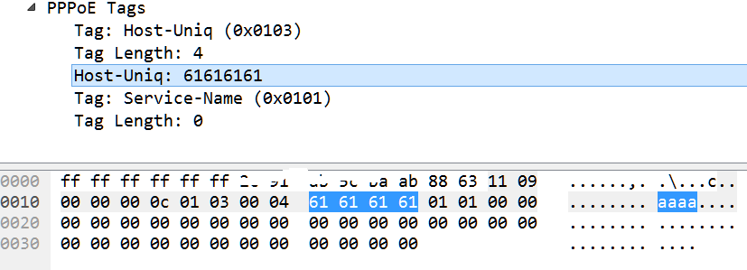

      My ISP use host-uniq, but if I fill the field in the GUI, wireshark show that values are sent in EBCDIC.
      PFsense config (example):
      pfsense uniq.PNG-
      Wireshark:
      wireshark uniq.PNG -

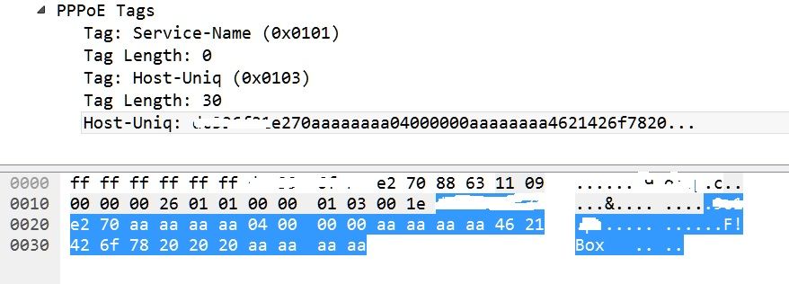

      Wireshark from ISP router (a Fritz Box, the erased bytes correspond to the WAN mac address):
      isp.jpg -

        Hmm, interesting. Entering an ascii string there converts it to hex and ! should be valid. Looks like there's an input check bug there.
        However you can also enter hex values there directly. I tested with 0x74657374, "test".
        You can see the generated mpd conf file in /var/etc to check. It just uses the hex value directly so you should be able to enter it that way.

                            After some debugging I found that the ISP router sent out PADI packets with a weird timing
                            11:24:53.046530	XX:XX:XX:XX:XX:XX		Broadcast		PPPoED	58	Active Discovery Initiation (PADI)
                            11:24:53.707597	XX:XX:XX:XX:XX:XX		Broadcast		PPPoED	58	Active Discovery Initiation (PADI)
                            11:24:54.707684	XX:XX:XX:XX:XX:XX		Broadcast		PPPoED	58	Active Discovery Initiation (PADI)
                            11:25:06.707842	XX:XX:XX:XX:XX:XX		Broadcast		PPPoED	58	Active Discovery Initiation (PADI)
                            And it always start working after the the 4th packet is sent. I cannot see the PADO anyway, probably it's filtered by the ONT.
                            There is also a sort of counter in the corresponding host-uniq field.
                            Host-Uniq:XXXXXXXXXXXXaaaaaaaa01000000aaaaaaaa4621426f7820...
                            Host-Uniq:XXXXXXXXXXXXaaaaaaaa02000000aaaaaaaa4621426f7820...
                            So I gave up, it's completely out of standard.
