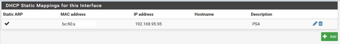

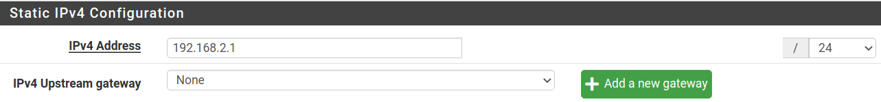

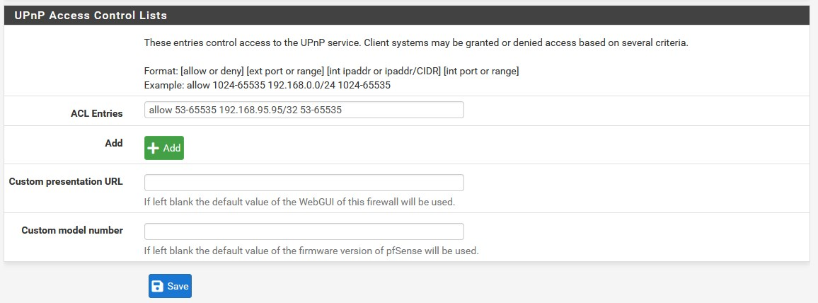

            okhay let's see:
            BTW:
            Be careful with UPnP, I recommend to install it only on a separate interface!!!
            +++edit:
              droidus
              Thank you for that. I am still having issues though.
              I've also put in some DNS servers.
              I hope this helps.
