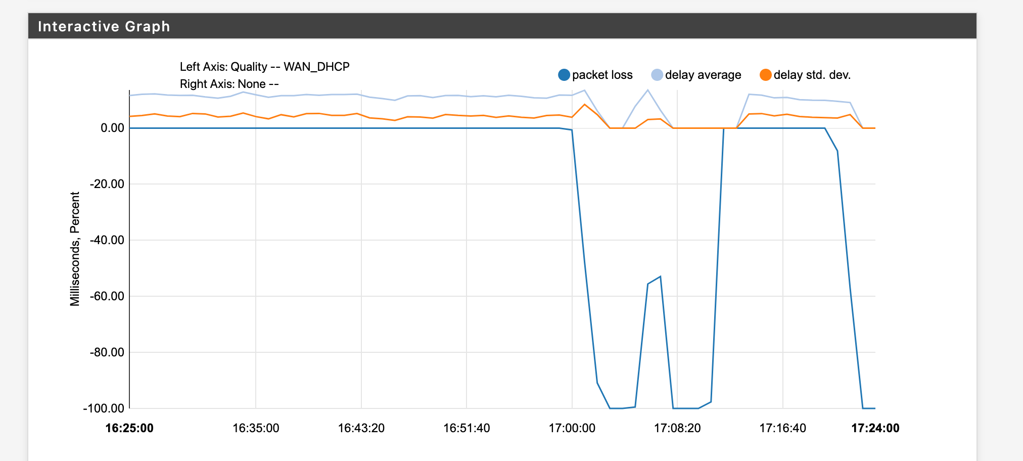

              Here's what it looked like throughout this mornings issue.

                Yes, there is a checkpoint, watch the log output of the WAN GW monitor...(dpinger)
                  Gertjan @DaddyGo
                  @daddygo said in 2.5.1-RELEASE - Dropping LAN](Requires Reboot):
                  the output of dpinger can be seen in the logs, and is used to create the stats @tomv showed :
