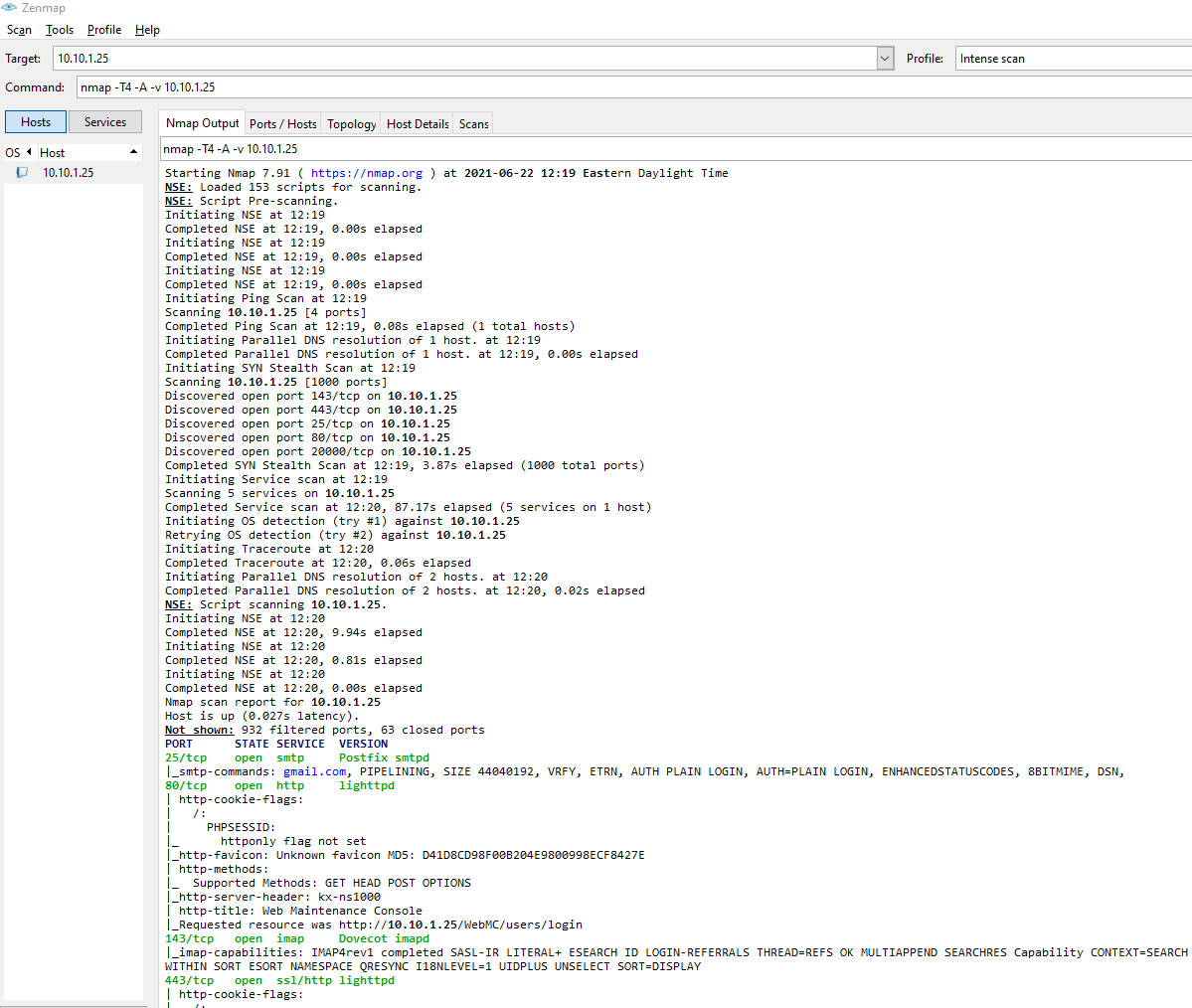

                      This is what I have (Does being on a VPN change it ?
                      Should this scan show the other ports ?
                      Scanning 10.10.1.25 [1000 ports]
                      Discovered open port 143/tcp on 10.10.1.25
                      Discovered open port 443/tcp on 10.10.1.25
                      Discovered open port 25/tcp on 10.10.1.25
                      Discovered open port 80/tcp on 10.10.1.25
                      Discovered open port 20000/tcp on 10.10.1.25
                      Should I see the others ?
                      I also think I owe you two a beer for sure !
                      • NogBadTheBadN
                        NogBadTheBad @Cire3
                        @cire3 said in Only Some of my Port Forwards work ?:
                        @nogbadthebad Just downloaded it and going to check it out, didn't know about the Windows Version :)
                        I'd run the test when disconnected from the VPN and try to establish what you were told by port forward ties up.
                        Andy
