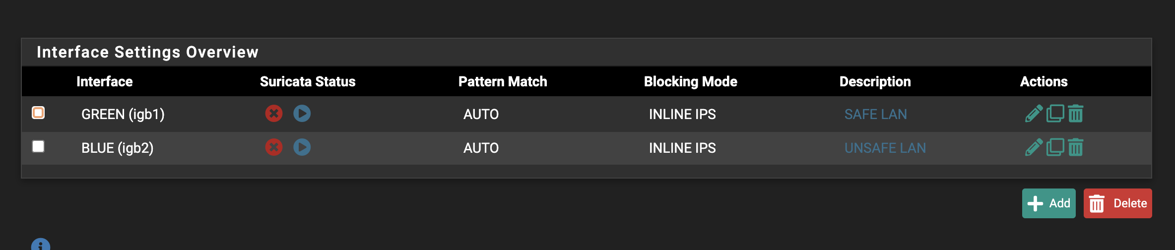

            • P Offline
              ProperCactus Rebel Alliance @bmeeks
