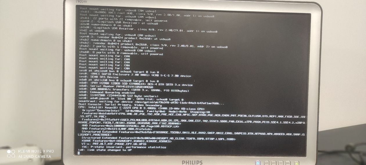

          i can't see any error, neither can i see the log because the pfsense stop loading at the Lo interface and the keyboard is not reponding anymore. i juste know that it still working cause when i plug or unplug an usb key the console show it.

            So it stops booting?
            Can you take a screenshot or photo of where it stops? (Or copy/paste the whole boot output if it's a serial console)
              that is where it hang.
              • jimpJ Offline
                It says in the output there that it's using the serial console as primary, not video.
                So connect to the serial console and see what's going on there.
                If you are restoring a config from a system that had a serial console and this one doesn't, you'll need to edit the config and remove the console config before restoring.
                Do not Chat/PM for help!
                  You can also force it to boot with video as the primary console:
                  https://docs.netgate.com/pfsense/en/latest/troubleshooting/boot-issues.html#booting-with-an-alternate-console
                  Once you have fixed whatever the problem is, probably an interface mismatch, you can set the primary console in System > Advanced > Admin Access.

                    I feel so stupide to haven't think about that alone, you were completly right as soon as ii changed serial to vga i could see all the boot.
