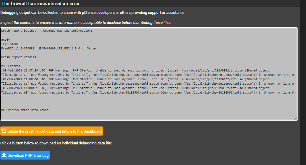

      Hello.
      After upgranding from 2.5.1 to 2.5.2 and restarting, a window reported about a PHP crash.
      Should I worry?
      The text:
      Crash report begins. Anonymous machine information:
      amd64
      12.2-STABLE
      FreeBSD 12.2-STABLE fd0f54f44b5c(RELENG_2_5_0) pfSense
      Crash report details:
      PHP Errors:
      [08-Jul-2021 21:07:59 UTC] PHP Warning: PHP Startup: Unable to load dynamic library 'intl.so' (tried: /usr/local/lib/php/20190902/intl.so (Shared object "libicuio.so.68" not found, required by "intl.so"), /usr/local/lib/php/20190902/intl.so.so (Cannot open "/usr/local/lib/php/20190902/intl.so.so")) in Unknown on line 0
      [08-Jul-2021 21:08:00 UTC] PHP Warning: PHP Startup: Unable to load dynamic library 'intl.so' (tried: /usr/local/lib/php/20190902/intl.so (Shared object "libicuio.so.68" not found, required by "intl.so"), /usr/local/lib/php/20190902/intl.so.so (Cannot open "/usr/local/lib/php/20190902/intl.so.so")) in Unknown on line 0
      [08-Jul-2021 21:08:01 UTC] PHP Warning: PHP Startup: Unable to load dynamic library 'intl.so' (tried: /usr/local/lib/php/20190902/intl.so (Shared object "libicuio.so.68" not found, required by "intl.so"), /usr/local/lib/php/20190902/intl.so.so (Cannot open "/usr/local/lib/php/20190902/intl.so.so")) in Unknown on line 0
      No FreeBSD crash data found.

        I upgraded from 2.5.0 to 2.5.2 and encountered an identical error (3 warnings about libicuio.so.68 being required by intl.so.so but not found).
          If you delete it and reboot does it return?
          Are you seeing any other problems besides that warning?
          There are numerous PHP warning flagged during the upgrade because of the changed to the PHP version and all the files depending on it. They are all suppressed during the update itself but it's possible you may have something additional if you had anything unusual installed.
          If they do not return at each boot they are probably artifacts from the install and not a problem.

            @stephenw10 said in After upgrading The firewall has enountered an error:
            After updating the installed packages and rebooting the warnings had gone.

              @stephenw10 based on observation over the past day (or so) it looks like a one-time thing.
