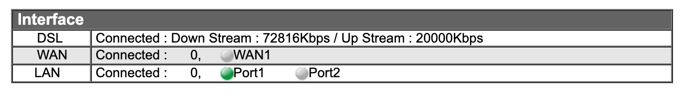

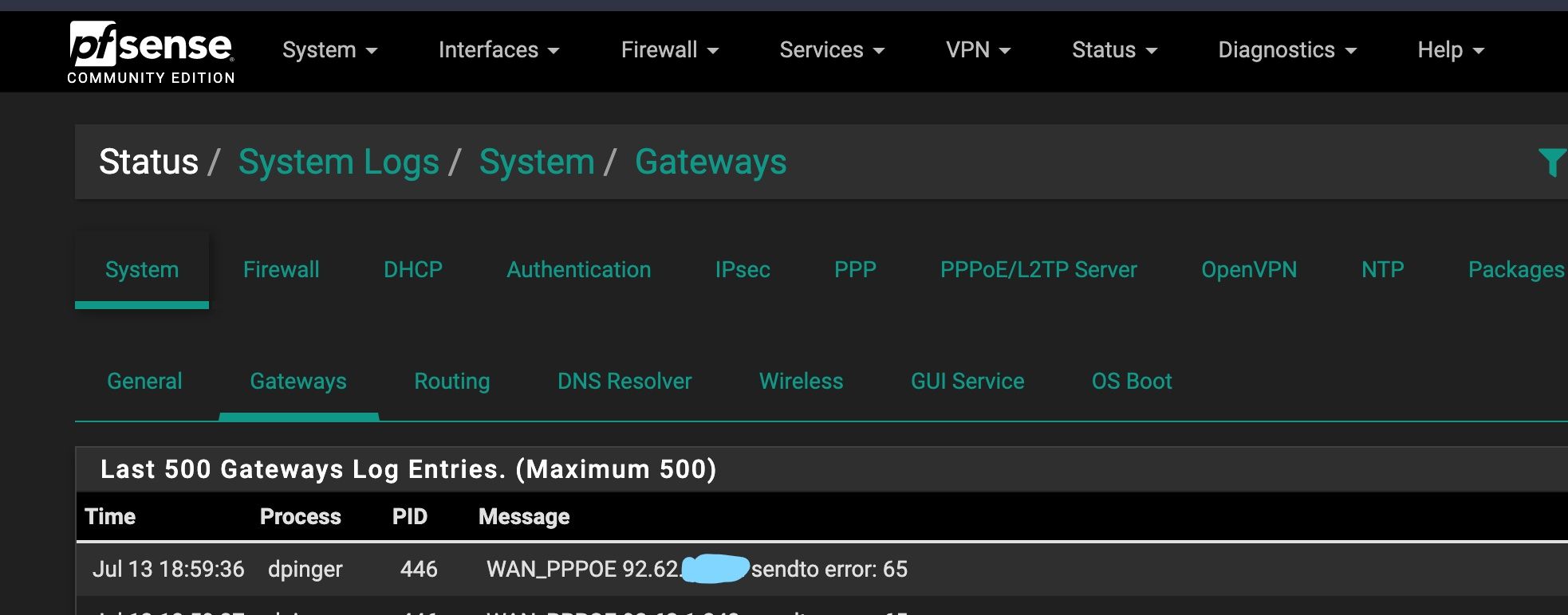

      I have a VDSL service here in the UK (ISP = Cloudscape Connect), this feeds into a Vigor166 (was a vigor130 but i replaced it for this fault), this in turns feeds a WAN interface on the server machine with a LAN interface going off to PC, Laptops etc.
      It appears almost like clockwork at 19:00 every 9 or so days the WAN interface goes down
      I can still access the modem on it's IP so that link works and it in turn shows a sync'd connection

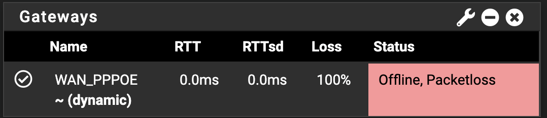

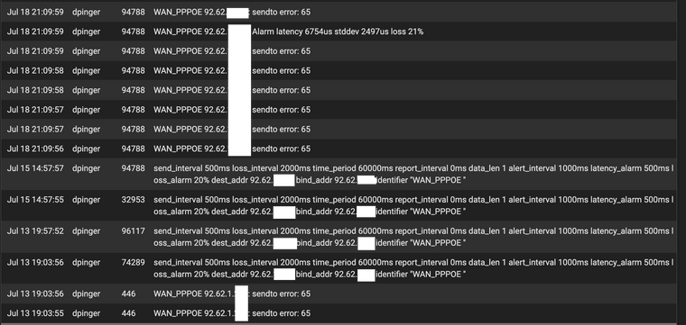

      In the gateways log I get sendto error: 65
      The only way i have found to get internet flowing on the LAN is to reboot the draytek.
      I have asked this on the spicework forums and they were really helpful. My ISP seems to be saying they are fine so must be PFsense so come straight to you guys incase i have missed anything.
        Send to error 65 implies there is no route to the gateway.
        Though the fact it shows 'dynamic' there and not the actual gateway IP implies the PPP session has gone down, is that the case? Does it show down in Status > Interfaces?
        You can still reach the modem interface so it doesn't appear to be a problem with the link there.
        That also means you could run a packet capture on that interface and see the PPPoE traffic, if there is any.
        First thing to do though is check the PPP logs to see what happened when it failed.

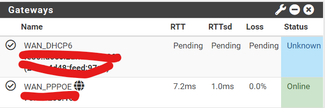

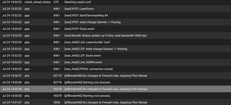

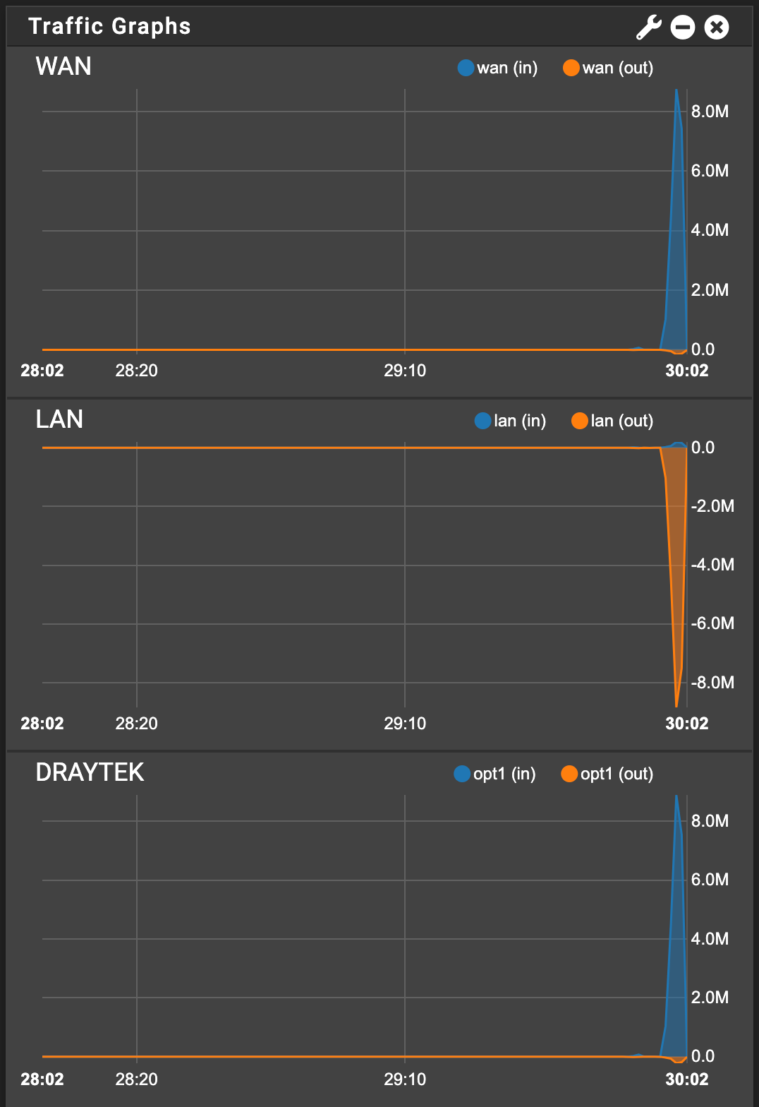

          @stephenw10 Thanks for the reply.

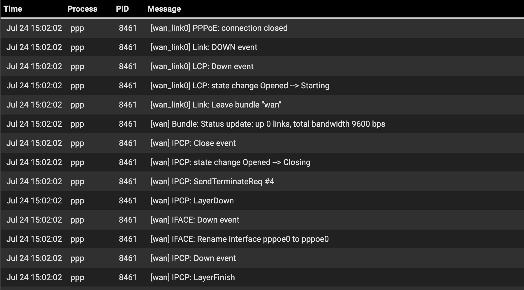

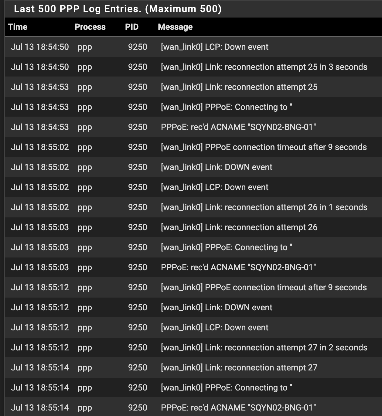

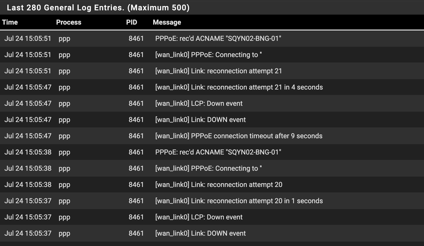

          And the logs at the time of it going down.
            Those are the logs after it disconnected showing it trying to reconnect.... and failing.
            Really the logs covering when it actually failed would be be better. It does look like it's at least receiving something though.

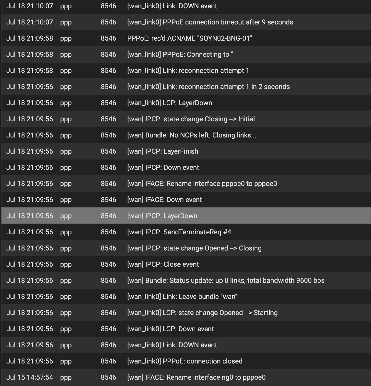

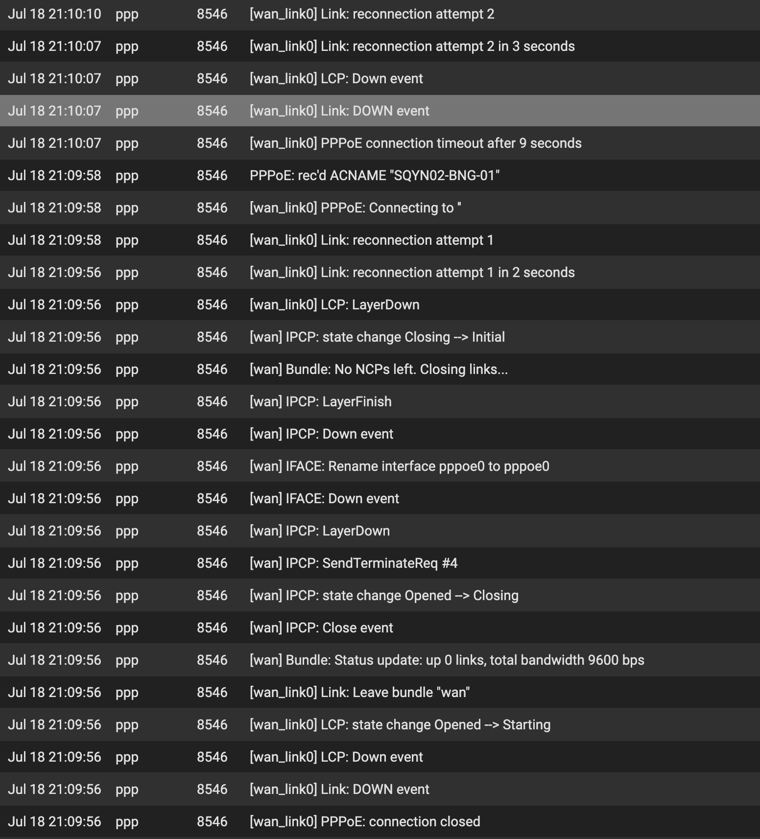

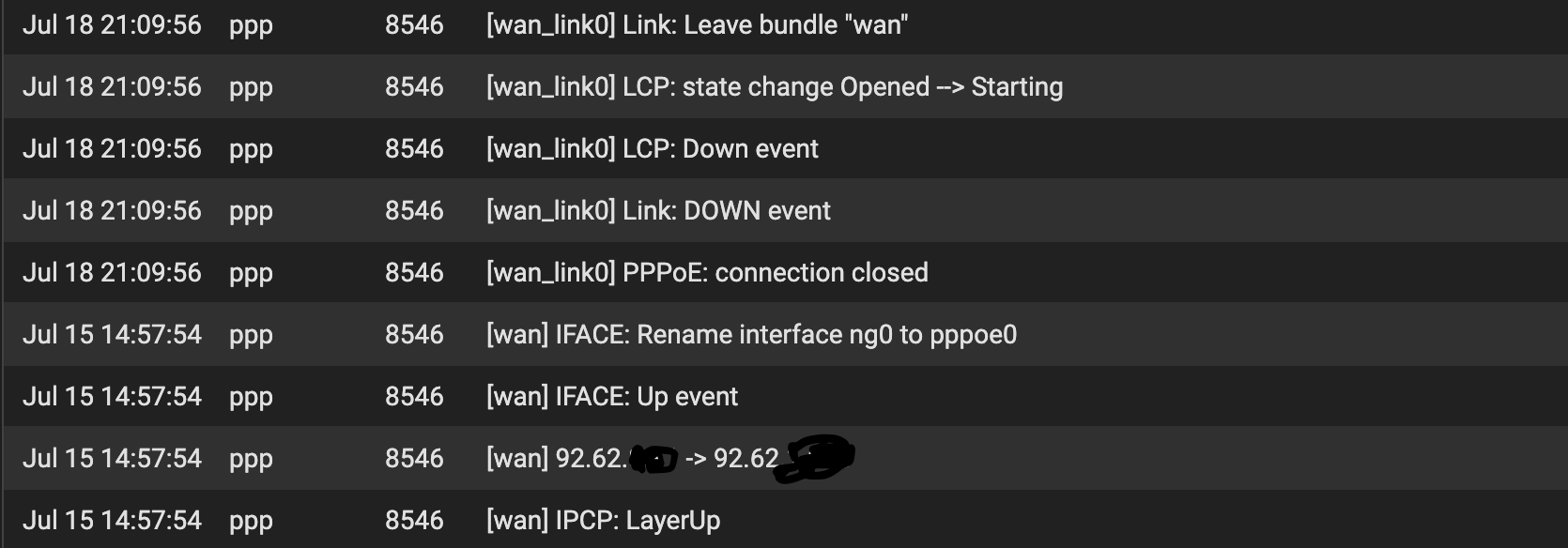

                So it actually went again but before just rebooting the draytek modem I tried a few things.
                In ESXI i disconnected and reconnected the WAN virtual NIC - no difference
                Rebooted PFsense VM - No difference
                Here are the logs and what i saw.

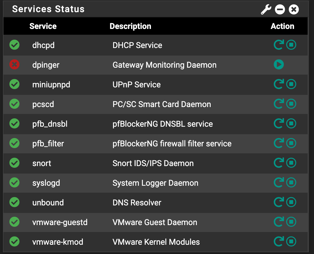

                Screenshot 2021-07-18 at 21.14.47.png Screenshot 2021-07-18 at 21.13.16.png Screenshot 2021-07-18 at 21.11.30.png
                As per before i reboot the modem and the link comes back.
                  What I expect to see there is either something like 'LCP echo timeout' or something from the servers side closing the connection. Unfortunately those would have been imediatelt preceding those logs if there were there.
                  F022YF 1 Reply Last reply Reply Quote 0
                  • F022YF Offline
                    F022Y @stephenw10
                    @stephenw10 Sorry nothing like that
                      Hmm, that implies it was closed deliberately for some reason. What do the system logs show at that time?

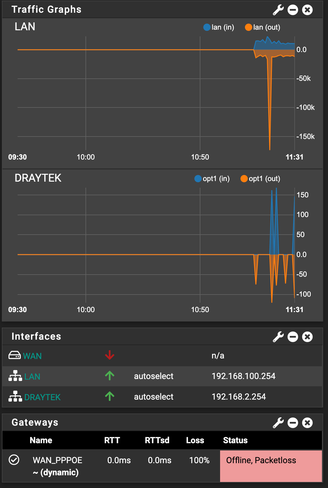

                          • F022YF Offline
                            F022Y @stephenw10
                            @stephenw10 So under Gateways i have this at time of fail.
                            From PPP
                            None of the other logs show anything at that time.
                              Nothing in the main system log? I expect to at least some duplicated entries there.
