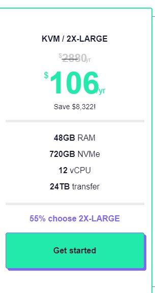

We have moved from OVH to SSDNodes in Amsterdam and Dallas, this is more than enough for a DB server(s) full KVM, full root access you can do whatever you want...
the cheapest on the market, massive telecom power "w" Tier1 DC, 10Gig connectivity, ultra fast customer service + NVMe
we use these plans:
@daddygo Yeah, but like I said - I had some problems with IPSec before using Strongswan - now I'm testing stability with PFSense.
When it comes to provider the price is nice, but you're probably paying those $106 one or three years and after that $2880, and that price isn't as attractive anymore. You can pay it or migrate to another provider again.
That's what I thought at first, but it's not, if you keep the VPSs (permanently), it gives you a perpetual guarantee on the price.
Not to mention the perpetual free daily full snapshot backup.

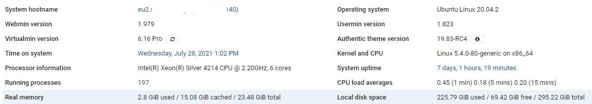

It's unbelievable, but I've moved 12 VPSs and they have great customer service, they're nice, fast...
Yes in this world it is hard to believe that there is such a thing.
I can only attest to the real VPS performance, in a KVM environment, without any continuations problem, yeah so great.
