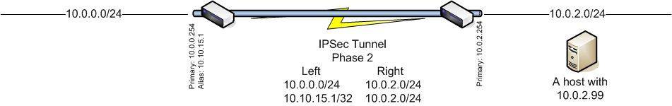

      I have two pfSense 2.5.2 boxes connected via ipsec. On the first box i have an ip alias 10.10.15.1/32 and on this alias is a webserver running at tcp port 80 and 443 - it's the webserver from pfBlockerNG-devel. My goal is to reach the webserver on 10.10.15.1 from the right side (10.0.2.0/24). This is my schema below.
      My host 10.0.2.99 can ping my ip alias 10.10.15.1, i can see the traffic flowing on 10.0.2.254

      Interesting is, i can not see the traffic on the other side (interface with 10.0.0.254).
      More interesting is, if i issue a telnet to 10.10.15.1 on port 80 from 10.0.2.99 to check if i can reach the http server, then i do not get any response.

      Interesting is, i also can not see the traffic on the other side at (interface with 10.0.0.254)...

          The traffic goes through the IPSec tunnel because the networks are defined in IPSec phase 2.
